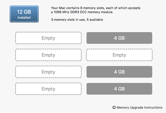

I just moved the #5 ram into slot 6 and I still have the same 3 slots showing filled. I'm going to try to tighten the heat sinks a bit more. I didn't want to overtighten, but I'll try a bit more. Is there a torque spec for them?
When I swapped my CPU’s I tightened the screws a quarter of a turn at a time until all ram came back

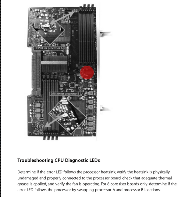

ok I now have 7 out of 8 ram slots back , but 6 shows empty. I also have a red light on the left heat sink. Is that processor one or two?
I went in and tightened down the heat sinks, tighter than I felt good about-Till they felt snug and stopped. Maybe too tight?
if I am looking inside with the cover off and the top of your illustration is on my right, then i see a red light here.
