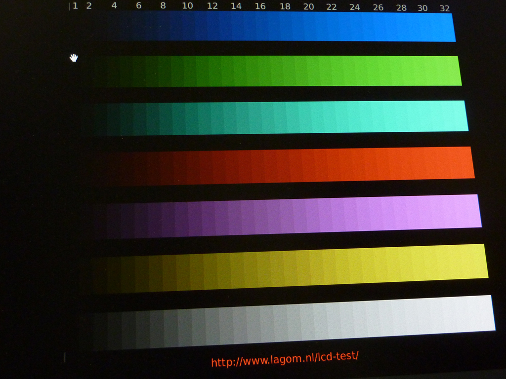

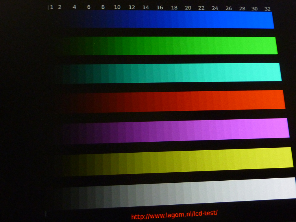

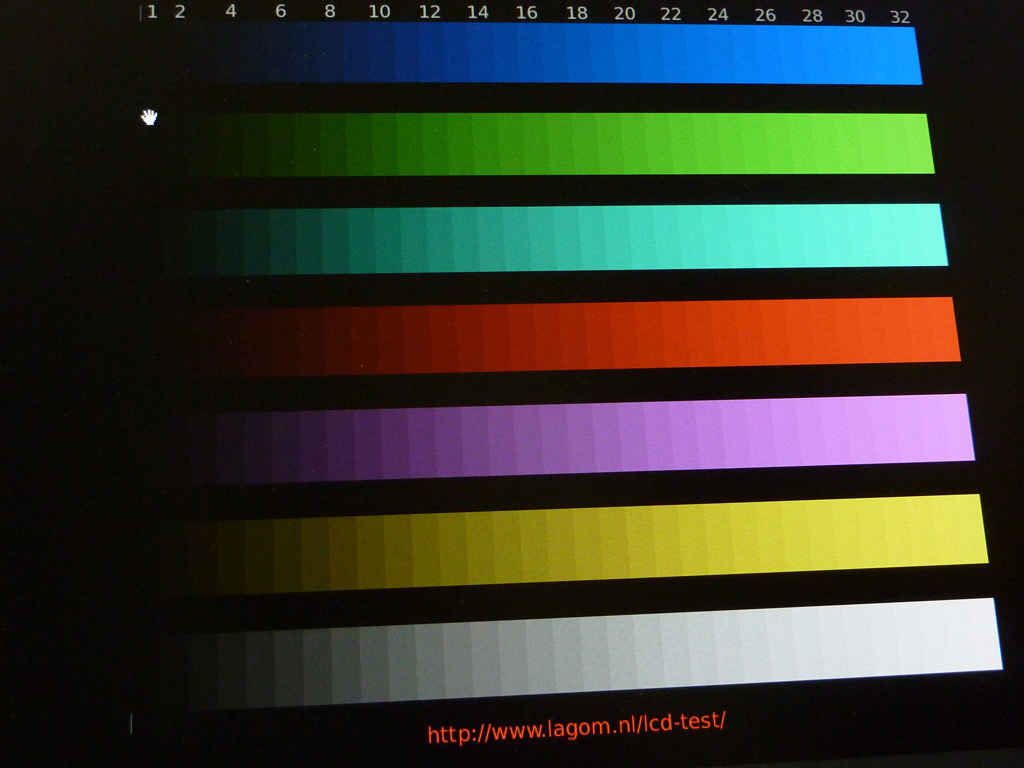

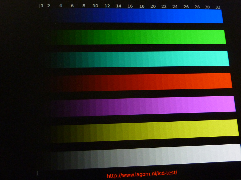

OK, here are some pictures. I'm impressed that my camera was able to pick up the difference. It is a Panazonic ZS3 (TZ7) with no manual controls. The shutter speed on the Mac picture is 1/20s and on the Windows picture it is 1/25s. The rest of the parameters are identical. Despite the difference in shutter speed, I would say the pictures somewhat accurately represent the difference when viewed on my 2209WA connected to my PC. When viewed on my MBP, the difference it only slightly visible, but the Windows picture still has a bit darker and more saturated color.
The monitor also has a burn-in fix mode that cycles through different colors (red, green, blue, cyan, magenta, yellow, and white). The colors shown in that mode are basically the colors I'm seeing on Windows, and they show the full gamut of the monitor.
The first one should be the Mac one and the second one should be the Windows one. The mouseover text has the file name which indicates which computer was used.
Edit: I implied this in my post, but these images will not reproduce well on all LCDs. The Unibody MBPs are probably a bit better than mine, but ideally these images should be viewed on an iMac or ACD with an 8-bit panel (IPS, PVA, MVA, etc.)
