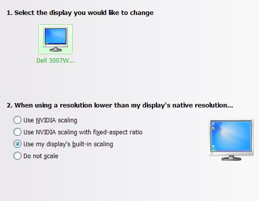

I should also note that I don't believe my graphics card is doing any sort of scaling on behalf of the monitor.
It shouldn't be. When you set a resolution on a computer, or Blu-Ray player, or Xbox 360, or whatever, that is the resolution that is coming out of the box. Its up to the display to take that signal, and get it displayed. The box sending it doesn't know what happens once its out there.

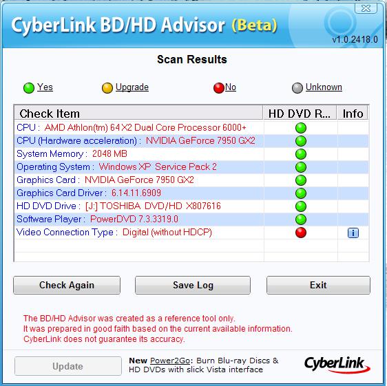

Maybe you missed this part, and I quote...

I will be happy to provide another at 1280x800 that shows all green, if you wish.
The 7950GX2 was one of the first, if not THE first fully HDCP compatible card. As you can see it fully passes the test. The monitor, however, does not. This screenshot was taken at native resolution.
Somewhere in your apparent rush to prove me wrong, you missed all the times I mentioned running the monitor on my tower.
(edit: I should note that I can run the monitor at 1920x1200 or any other 16:10 resolution under windows on my tower just fine
An even bigger clue, is that i mentioned running Cyberlink's program, which is windows only to my knowledge. Even more so, is there even capability in Mac for playing HD/BR? I do know that the 360 drive works fine on it. Your friends drive may work fine with his pc (my borrowed drive does) but if you were to actually try to play a restricted disc (Transformers, as my example) you would fail. I've since found many articles lamenting this monitor's ability to use HDCP at anything but?/over? 1280x800. You can search them yourself. I'm dismayed at Dell for not making the buyer aware of such a limitation.
Now, I apologize for any lack of clarity I may have had, but it is fairly apparent, as I have mentioned, that you were so aggressively pursuing means to discredit what I said, you failed to actually read it. No harm done, as long as you now are able to understand why I'm upset at dell.
There is your answer, and I'll explain...

I had already tried that guessing that it may be the case, but this time I took a screenshot at your request.

Oh, and when I said earlier "i don't believe my card is scaling it", I wasn't wrong. Contrary to what you have indicated, it's perfectly possible to have the card scale the OS supplied image (say, from a full screen game or lower resolution full screen video player) and scale it to native for things like dumb televisions and projectors.
What this tells me is that the monitor can indeed run 1920x1200 without my card doing any work and sending the signal at the native resolution to it. But as I note later, there may be more to it than this.

This directly contradicts this information from AnandTech:
That brings us to perhaps the biggest flaw of the 3007WFP: HDCP support. While the LCD does include HDCP support, HDCP was unfortunately not created to work with dual-link DVI. If you want to use the 3007WFP to view HDCP protected content, you may find yourself forced to use a single-link DVI connection, which means you would only be able to run the display at one fourth of its native resolution. That's a pretty serious flaw, at least for those users who are interested in HDCP content.
So, upon basis of this, I maintain that your friend is NOT watching HDCP content on this display running any resolution over 1280x800. It's also a flaw not mentioned anywhere on Dell's page, I can't imagine they'd want to advertise that their premier (at the time) display is incapable of modern resolutions for HDCP. I should not have to search around the net to find these limitations out, they should be listed on the product page, hence my gripe.
Also, if AnandTech is to be believed, it is impossible to run dual-link HDCP on any combination, something I believe (but, I do not know, and do not purport to know) DisplayAdapter will fix.

Oh, and when I said earlier "i don't believe my card is scaling it", I wasn't wrong. Contrary to what you have indicated, it's perfectly possible to have the card scale the OS supplied image...
That wasn't what I was getting at. I mean, why would you set the video card to one resolution, only to have it scale it to something else? Thats silly. With LCD monitors, you have a fixed set of pixels, so ideally you set the video card to that resolution, and then your done with it. I have no idea why you would have the video card do any scaling like that.

Oh, and about the scaling thing. If it makes no sense, do you really think that nVidia would go to the trouble of writing not just one, but two driver based modes for it?
You got me. Like I said, I don't even know why you need one, let alone two modes for it. You set the resolution based on the display it will be shown on. So it seems to me like you would set it to output at that, and be done with. But, if nVidia put it in there, I'm guessing they have a reason for it. I'll be damned if I can figure out why though.
