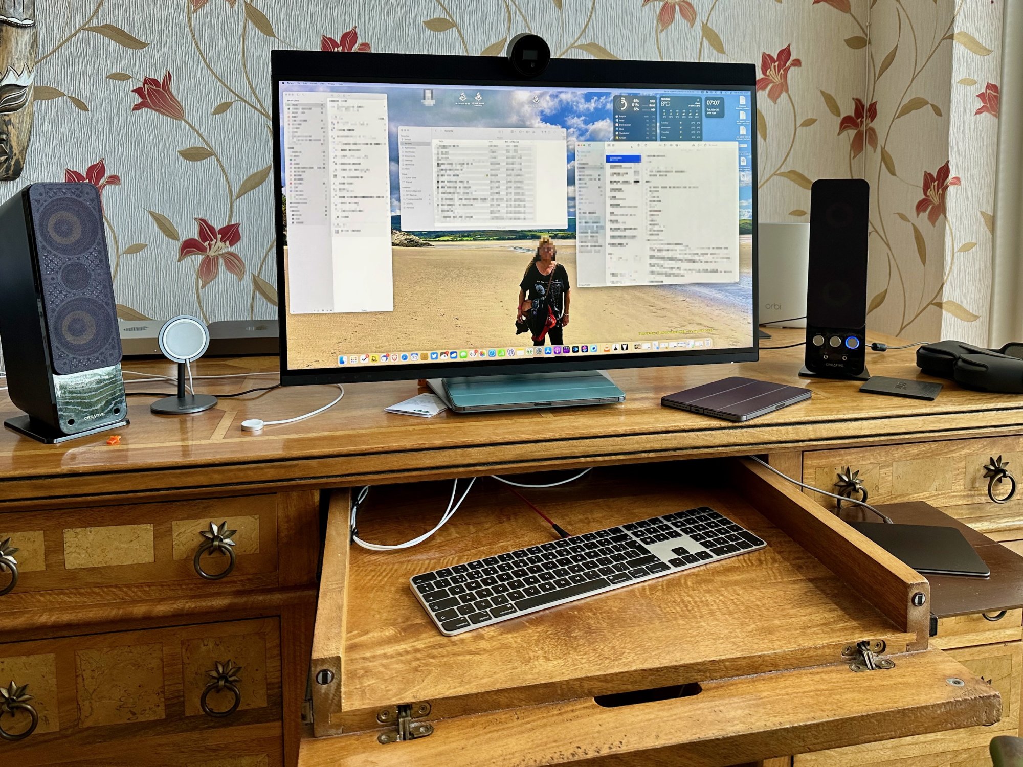

Creative Labs Pebble Pro is an affordable USB-C (power and sound) speaker.
I was considering them, but the green colour is horrid. I'll stick with my Creative T40 speakers, they may be a few years old (and a large) but they do give me decent sound.
