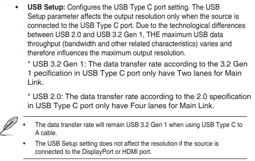

My Asus ProArt PA329CV monitor had different USB-C settings that would support either USB 2 or USB 3 speeds via the hub. It was set to USB 2.0 by default.

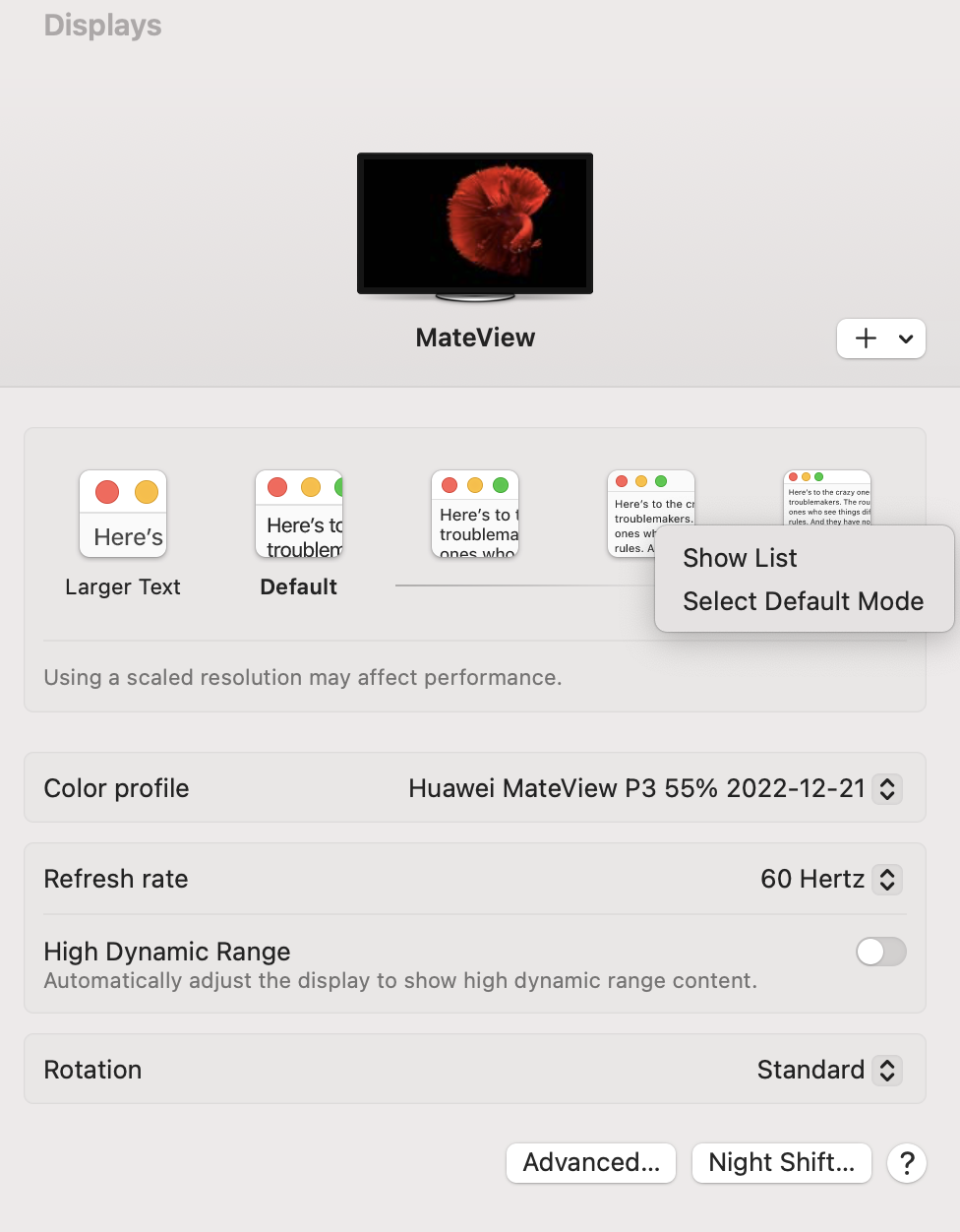

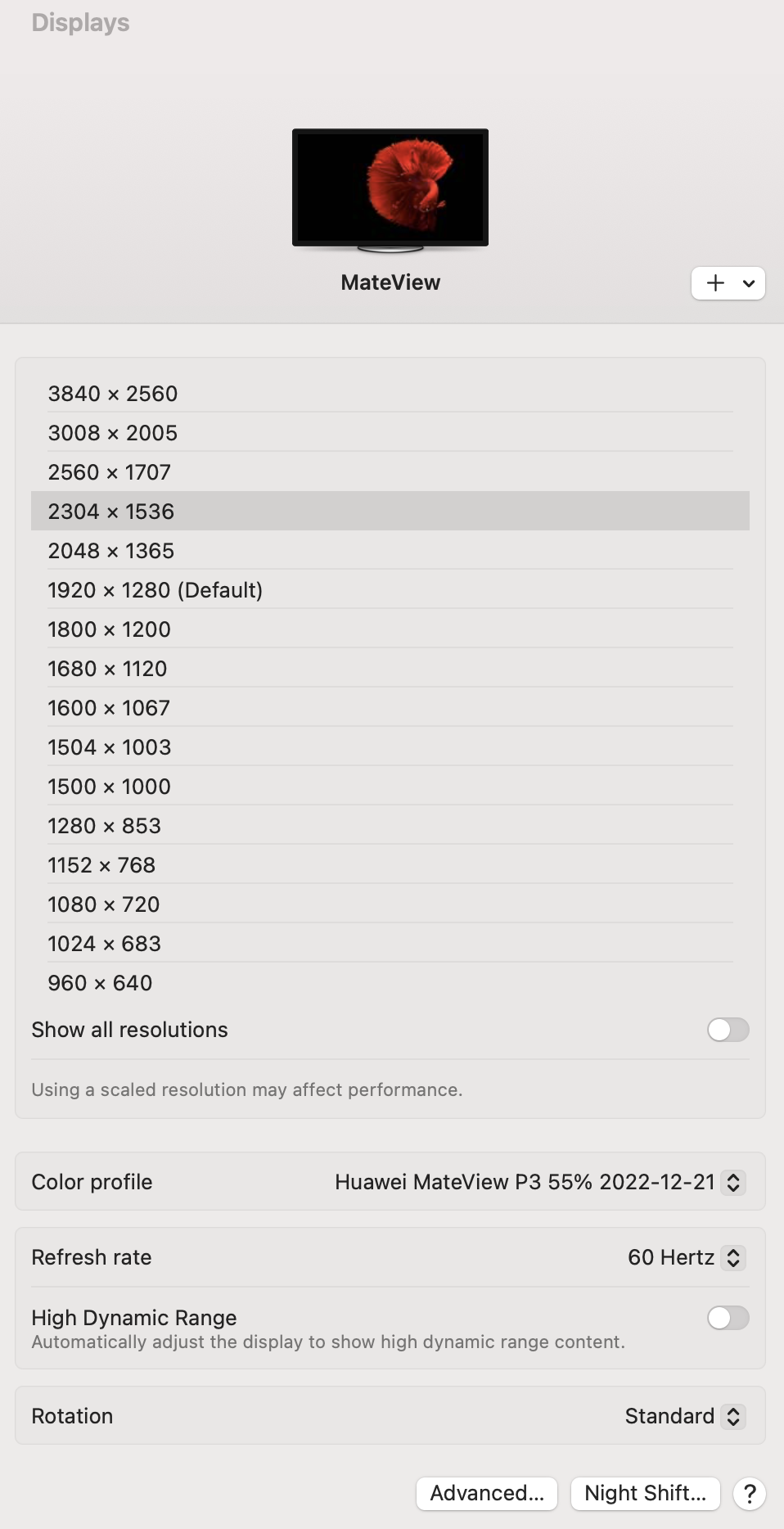

I have provided screenshots below to guide you. My particular 28.2" monitor doesn't have a high enough pixel density to function well at the recommended 2X scaling, so I use fractional scaling. My screen is 3840x2560, but I use 2304x1536, which works out to 1.67X scaling. That won't be quite as crisp as 2X scaling.
Thanks. Now I know what people were meaning by scaling. I have been in all the areas you included screen shots for and played around with them. I just thought scaling was more involved, referring to some type of view that made tool bars, apps, font, etc. larger and readable while at full resolution, not simply selecting different smaller resolutions.

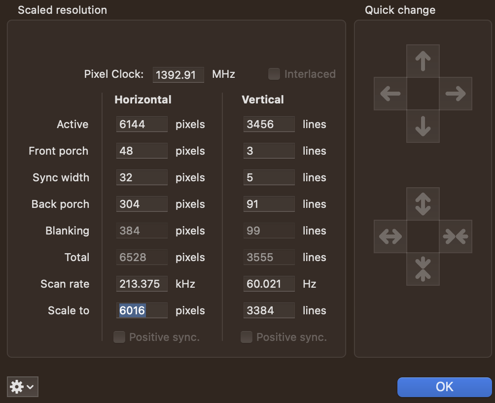

SwitchResX will show what the scale is (active pixels) when you double click a resolution in the Current Resolutions list. The 6016x3384 is a scaled mode that scales up to 6144x3456. If the EDID includes a 6016x3384 timing (as it does in the EDID that I've seen) then I think SwitchResX might have two different 6016x3384 modes - one that is scaled and one that is not. At least that's what happens on Intel Macs. Basically, macOS adds various scaled modes that all scale to the native resolution of the display (6144x3456). For example, my 4K display has 4 different 1280x720 modes: scaled lores (4K), timing lores (720p), scaled HiDPI (4K), timing HiDPI (1440p). SwitchResX can show the non-scaled (timing) modes in bold. The 1440p has VRR because it can do 144Hz. The 4K modes don't have VRR because 144Hz is not possible at 4K on my display (using single cable input). Apple does not allow VRR modes for modes that have max refresh rate less than the max refresh rate of the display.
As far as I can tell, the Dell does not give the user any way to explicitly choose USB 2.0 or USB 3.x. Using Thunderbolt 4 or the USB upstream cable should result in USB 3.x speeds, but my monitor, I sometimes get USB 2.0 speeds or no connection of the built-in peripherals at all.

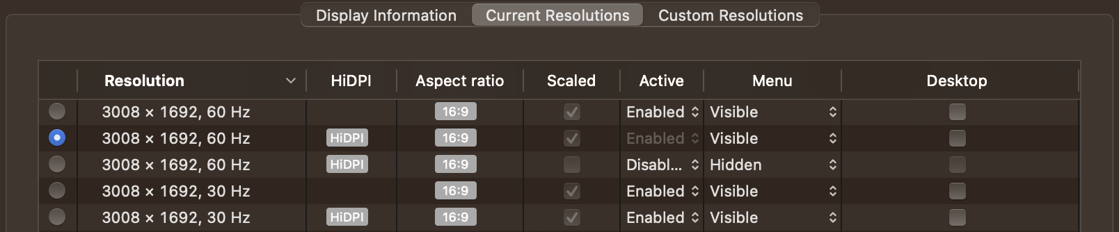

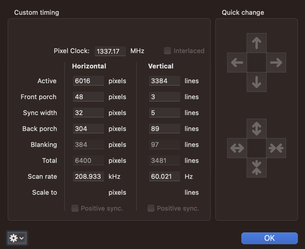

Thanks for the all info! I certainly was surprised that 6016x3384 output, by default, ends up actually resulting in 6144x3456 being output to the monitor, particularly since 6016x3384 is a supported input mode on the U3224KB. Thankfully we can get the native 6016x3384 signal via the faking features in BetterDisplay. I've looked at SwitchResX and it lists five options for "3008x1692", where the HiDPI modes really mean "6016x3384 but looks like 3008x1692":
Here is the detailed info for the second mode (the selected one), which is actually sent to the monitor as a 6144x3456 signal:
So far, I've not been able to coax SwitchResX to push an actual 3008x1692 HiDPI signal to the monitor, i.e., a 6016x3384 input signal. The options in SwitchResX all still result in a 6144x3456 video signal being pushed out instead, whether or not BetterDisplay is used to fake the native panel resolution as 6016x3384. Also, I tried to enabled the third mode, by enabling it, making it visible, and then trying to activate it, but SwitchResX wouldn't activate it.

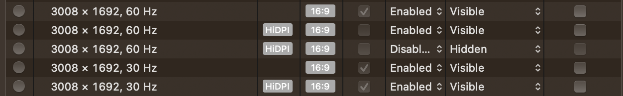

The third option appears to be a mode that would output 6016x3384. Did you double click it to verify the timing info? Strange that SwitchResX won't let you use it. You can try disconnecting the display for a few seconds then reconnect it to make SwitchResX rebuild the list. You can try selecting the option in the SwitchResX menu instead of the SwitchResX app.
All agreed, but I'm not sure why SwitchResX won't let me activate it. It's possibly the timing info is incorrect or too off, as the Dell manual says the pixel clock should be 1323.25 MHz for 6016x3384, but SwitchResX says the pixel clock for that third mode is 1337.17 MHz. Here is a screenshot of the detailed info for that third mode from SwitchResX:
Yes, I tried all of that previously, but none of it worked. I suppose I could try making a custom mode so that the pixel clock exactly matches what's reported in the manual to see what happens, but to be honest, it doesn't really matter to me at this point. Now that I understand the differences between how the HDMI and Thunderbolt video options behave when using the U3224KB with an M2 Pro Mac Mini and how to get the most out of both video paths (e.g., the 6016x3384 workaround by faking the native resolution via BetterDisplay), I'm pretty satisfied with the video performance on the U3224KB over either connection.

This monitor is absolutely no go.
I have my old MacBook Pro 2018. When connected directly is shows strange resulutions which does not look like scaled (e.g. 3300x2k something). Ok, that was expected (the macbook does not properly support these resolutions)
When connected through Blackmagic eGPU, resolutions list becomes normal, but it can only do 6144x3456 or scaled 3072x1728 at 30Hz. Ok, this was also expected.
When connected to Dell Windows laptop it produces the full resolution at 60Hz.
Now, the image quality. I compare it to iMac 27 late 2015 retina display... and iMac is sharper and brighter. Any change in settings does not help. It is simply as it is.
HDR is nightmare. For YouTube HDR videos it is okay (iMac screen without HDR still looks better). For my own HDR videos filmed on iPhone they become overexposed (no contrast, too bright). None of HDR settings help to fix it.
Other minor things: USB ports are not charging when the monitor is off (except the main 140W input). There is only one Thinderbolt input with video capacity, so if I have two laptops or a Mac laptop and Mac Studio, I have to use HDMI which loses all attached peripherals. If I mute mic or switch off camera from the front panel, it always shows it is muted in red, there is no way to switch off all the lights. The edges of the screen are illuminated (visible when it is black).
And, finally, it has died after a day of use. It switches on, a computer says there is a monitor attached but nothing is displayed. Just blank screen. When fully disconnected (only power cord) no on-screen menu or no signal popup visible. Really helped me with the decision to return:)
A courier is picking up it on Friday. At least return are good for it (I hope I get my money back soon).
From what you written, it sounds like some of the unexpected problems you experienced were due to both getting a lemon and missing some key setup items (more specifics on both of these inline below).
Just FYI, I also initially got a lemon, as did Macdude2010. When I first got my Dell, I noticed that the shipping box was pretty beat up, and I had various problems with the builtin USB peripherals being flaky. I spoke to Dell support, and within two days, I had a replacement monitor, and so far, the replacement seems to be working normally (although to be sure, I am still testing, which is why I haven't yet written any update here). I've been pretty pleased with Dell's support.
Indeed, this is all expected, as your MacBook is five years old and presumably the Blackmagic eGPU is about that old too. Older hardware simply isn't going to have the newer video connectivity options that are needed to properly drive a 6K monitor at native resolution and 60Hz. One really needs to have a computer with Thunderbolt 4, DP 2.0, or HDMI v2.1 to take full advantage of this Dell 6K monitor.
Presumably this is a fairly recent Dell laptop with Thunderbolt 4, DP 2.0, or HDMI v2.1, yes?
Regarding the sharpness issue, did you double check that either macOS or the monitor wasn't rescaling the video? That would definitely lessen the sharpness. There are some pitfalls here; see this post of mine (as well as others in this thread) on how to properly configure things for the best output.
I had an iMac Pro until recently and I'd describe the glossy iMac screen as more vivid, but I don't find the Dell a downgrade in terms of actual brightness and sharpness. It seems just as sharp to me, and at max brightness, I find the Dell too bright for normal work, unlike my iMac Pro, which I could use at max brightness. Overall, I've been pretty pleased with the matte finish on the Dell. It's not as matte as the LG 38" UltraWide that I've also used. But glossy versus matte is a very personal thing.
Interesting. Thanks for the report. I haven't tested HDR, as it's not something I need with this monitor.
This can be enabled via OSD -> Personalize -> Other USB Charging -> On in Standby Mode. When setting up the monitor, the OSD says that this is disabled by default due to energy saving reasons.
When using HDMI or DisplayPort, there is an included USB upstream cable that also needs to be connected so that the monitor's builtin peripherals and USB ports will work. This is what I do. My Mac Mini is connected using HDMI and the USB upstream cable, and I leave the Thunderbolt cable available for when I want to connect or charge my MacBook Pro. The Dell OSD even has settings to pick whether or not the peripherals should be switched from Thunderbolt to/from the USB upstream cable when switching video inputs; see OSD -> USB -> mDP assign to and OSD -> USB -> HDMI assign to. I think this all works really nicely and is more customizable than I was expecting. I think Dell did this right.
This really annoyed me at first too. Presumably Dell did it this way so that it's always clear when the user has muted the mic or closed the camera privacy shutter using the monitor controls. But since they are red LEDs and not screamingly bright like blue LEDs, I've found I can tolerate them (even in a dark room), unlike blue LEDs, which I abhor and often cover with tape. Still, I'd too greatly prefer if there was a way to set the monitor so that the red LEDs would be either significantly dimmed or fully turned off when the proximity sensor doesn't detect that one's hand is near the monitor control panel on the left side of the bottom bezel. Maybe Dell will release a firmware update to allow this. It would be a big improvement.
I think this is one sign that you got a lemon. I don't have this problem at all with my Dell (the first one I got or the replacement). The only other thing I can think of is that you were actually running the Dell at 1:1 resolution with an output that was less than the full 6144x3456 resolution of the display, and so you were seeing some of the actual screen being unused but backlit.
Sorry to hear that yours completely died on you! It really does sounds like you got a lemon. Good luck with the return and I hope the info above is helpful for any potential further troubleshooting.
Reactions: MikeDr206
