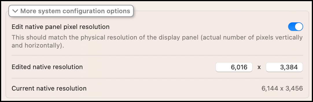

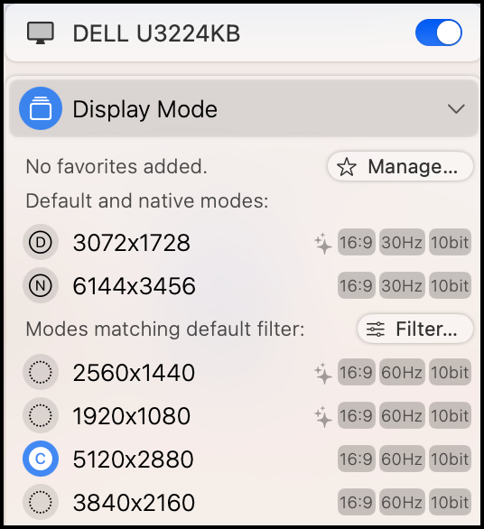

Just received my new u3224kb, but having a 2019 Intel based mbp with a Radeon 5500M, am disappointed that the best option available in display settings is 3360x1890@30hz. My $500 27" 4k looks better than this. Has anyone solved this or are we at the mercy of Apple? I've spent a couple hours reading through this thread and seems there is only hope for M1/M2 users.
This doesn't sound right, and while I'm not sure if I'm recalling this entire 30-page thread accurately ;-), I do think I recall that others here have reported achieving 6K @ 60 Hz with Intel-based Macs. Using my old 12" Macbook (Intel HD Graphics 615) and Apple's USB-C Digital AV Multiport Adapter, I just tested and got 3840 x 2160 @ 30 Hz over HDMI 1.4, which is better than you report you can get with your 2019 Macbook Pro. So something seems wrong with your setup. I suspect you can fix this problem by debugging, e.g., making sure you have the right cable, right settings, installing BetterDisplay, etc. So some questions:
  • How are you connecting to the monitor, a Thunderbolt cable or HDMI via an external adapter?
  • Are you passing through a dock first?
  • Did you follow the instructions that I posted earlier here on how to install BetterDisplay (the free version suffices) and configure the various settings in BetterDisplay and in the OSD on Dell?
EDIT: Just looking back at this long thread for posts that mention Intel, and indeed, it seems 2019 Macbook Pro users have had some difficulties, while Intel-based Mac Pro users with "real" GPUs are faring better. However, this post suggests that a fix for your case may be available in Sonoma, which will be released next week. This other post about possible hacks to enable DSC might also be helpful.
Hello, yeah I'm using the USB-C cable that came with the Dell, which has the thunderbolt logo on one end, and connects directly from the mbp to #7 in the dell (thunderbolt upstream). No adapters/docks/etc. Not using HDMI or display port because this mbp only has USB-C ports.
I saw the instructions you shared, but also noticed that was for TB4, so ignored them because this is TB3. Now, I've tried the instructions out, and for some reason whatever native resolution I set in BetterDisplay, never becomes an option to choose from. The highest resolution available at 60hz is 5120x2880@60hz which works, and is better than what I was getting before. Sad that I have to use a third party product for this though. I've opened cases with both Dell and Apple about this.
Here's a screenshot from BetterDisplay:
I've rebooted several times but never get an option to choose that native resolution. These are the options I get in the menu:
From your screenshots, BetterDisplay still says that 6144 x 3456 is the native resolution, even though you typed in 6016 x 3384 for the edited native resolution. I'm not sure what to make of this but hopefully some of the following comments and questions might help you troubleshoot it:
  • Are you sure that BetterDisplay actually updated itself to use 6016 x 3384, e.g., did you somehow miss applying the change? When I edited the native resolution, BetterDisplay strongly warned that I might need to reboot, but I actually only needed to let BetterDisplay restart itself.
  • Have you tried setting the native resolution and the default resolution both to 6016 x 3384, as I wrote in my instructions? Your screen shots only show the former.
  • Have you tried running either of the two 6K resolutions using only 24-bit color and/or 30 Hz refresh? Even on M1/M2 Macs, using 6144 x 3456 @ 60 Hz over Thunderbolt currently results in only 24-bit color.
  • What version of macOS are you using?
  • It seems you are using BetterDisplay 2, which is different than the version I am using (version 1.4.15). You might instead try also using 1.4.15 and then copying my settings exactly to see if that makes a difference.
Since I don't have the same hardware as you, I'm not sure what will be helpful. Hopefully something from above will lead to more progress. If not, it's probably worth waiting for Sonoma to be released next week to see if it will improve support of the U3224KB (but who knows if Sonoma will help at all -- I haven't tried the Sonoma betas or been following news on them).

Yeah the 5k is quite nice in terms of real estate. I'm starting to question if I'll run at 6k even if I get it working since the text will be so small, but am not giving up yet. Yes, I did also try setting default resolution, but still don't get that as an option to choose from. Also tried adding it as a scaled option, but only shows up for 30hz not 60. Every time I changed native or default, I got a warning and an apply button, clicked apply, then rebooted. Today I also tried changing color from 10 to 8bit depth, but that didn't provide any new screen resolution options. Am on Ventura 13.5.2. Unfortunately since this is a company owned laptop, when Sonoma is released, I won't be able to use it for a while. The good news is that the company is sending out M2 refreshes. However, it looks like they're sending the air, not pro, so I'm going to see if I can make a case to get the pro with HDMI 2.1.
Other thing I noticed is that when I connect a 2nd external display (4k), the U3224KB drops down to 3360x1890@30hz again. That was the dream - two external displays, one 6k and one 4k rotated vertically.
Unfortunately the M2 Air isn't going to support dual external displays. Although I think it will fix the issues you are having with the Dell.
I'm not certain but I think what you are dealing with is related to the Intel chip vs. Apple Silicon.
Good point on the M2 air, will have to make a case for a pro. I've got this 2019 Intel MBP to power both the U3224KB at 5k and another display at 4k. Had to lower the color bit depth to 8 bit for that to work. If I do any photo/video editing, will disconnect one and raise it to 10 bit. Apple support asked me to run a diagnostic from one of their custom tools. Not hopeful they'll resolve this but at least letting them know it's broken.
