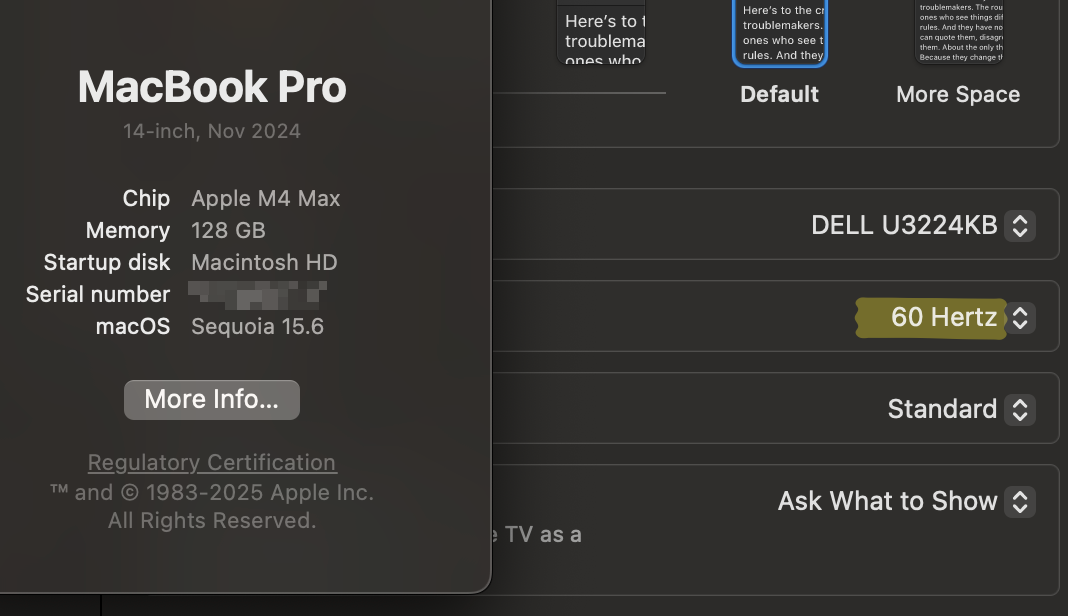

I recently upgraded to Sequoia 15.6, and now my Mac won't let me go past 30Hz. I'm using the CableMatters 20GB USB-C switcher, so I suspect the Mac isn't using DSC as it previously was. Is anyone else encountering this issue?
Hmm I can test this later - if you go to the connection info screen on the monitor it’ll tell you what mode it’s in, DSC etc under the “stream info” section.
Actually, DSC is being used! I just can't choose 60Hz as an option when selecting the native resolution (3072x1728@2x)
What happens if you use a Thunderbolt cable direct to the monitor?
Working ok for me, M1 MBP, cable matters usb-c to hdmi (flashed with the updated firmware), via a TB3 dock- as above.
Ah hang on, I've not applied the 15.6 update to this machine... let me do that...
..and working fine on 15.6 also.
I can confirm too. it works fine with 15.6 just as before.
But I'm using a thunderbolt 3 cable to connect MBP (M4 max) with the monitor directly. That's different. You may try a direct connection and see if the issue is with the switcher (or rather macOS's compatibility with it).
I don't use it much at all, but I seem to have lost the ability to enable HDR. I'm running an M1M Studio, TB4 and Better Display. In the early days I used the BD hack but then things smoothed out and it worked normally.
Any ideas on what I might be missing?
I just had this happen on my M4 pro machine. Noticed it as the monitor was at 60hz but in 24bit not 30 (tb4 connection)
I toggled HDR on then off again in display settings and it went back to using DSC and 30 bit…
