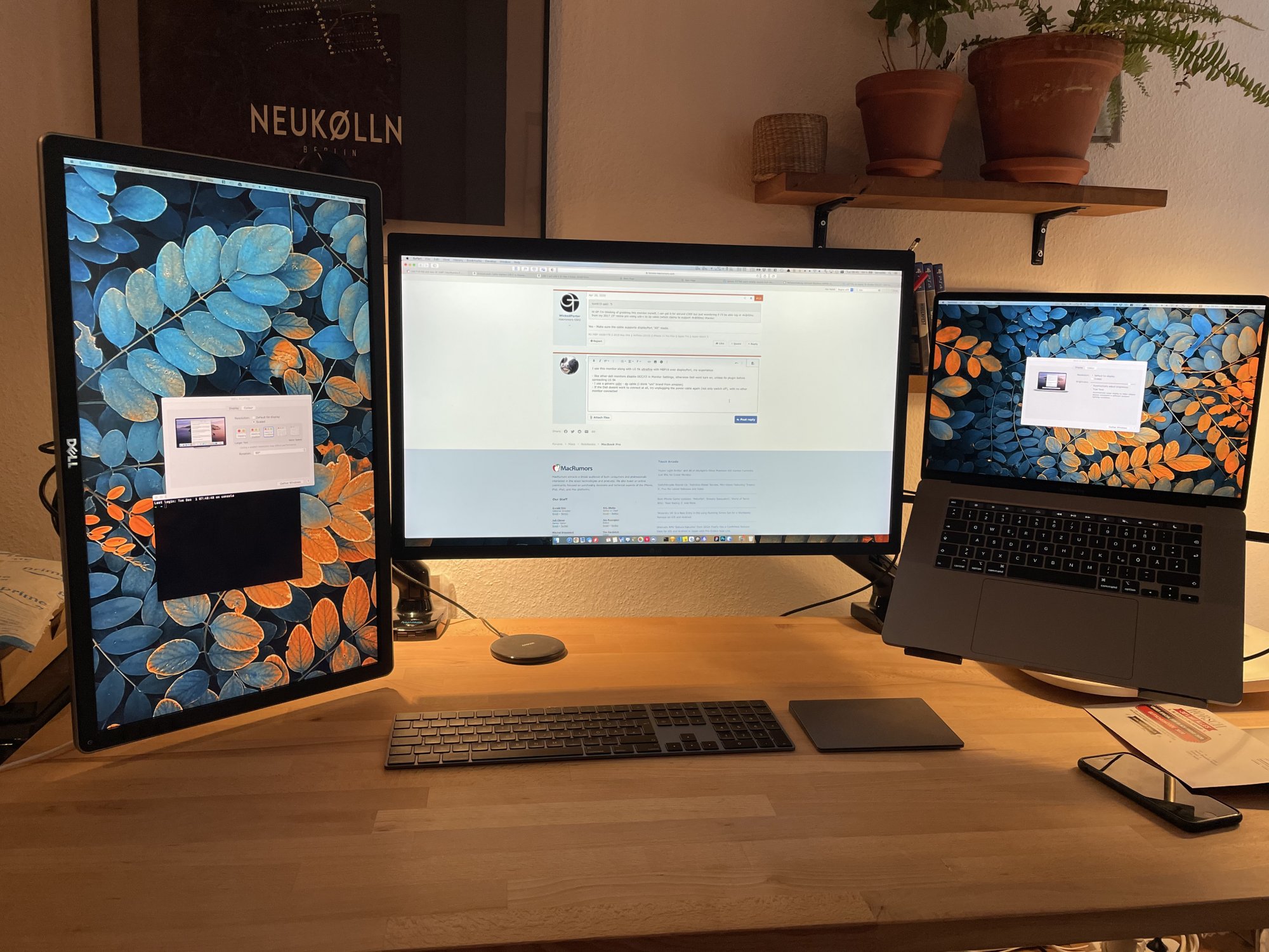

I use this monitor REV01 along with LG 5k ultrafine with MBP16 over displayPort, my experience:
- (when using multiple displays) disable DCC/CI in Monitor Settings, otherwise it wont turn on like other dell monitors, unless its plugged before connecting LG 5k
- I use a generic usbc - dp cable (I think "uni" brand from amazon)
- If the Dell doesnt want to connect at all, try unplugging the power cable again (not only switch off), with no other monitor connected (I have to do this sometimes after reboot of the macbook pro)
technologies works in mysterious ways... 🥶
