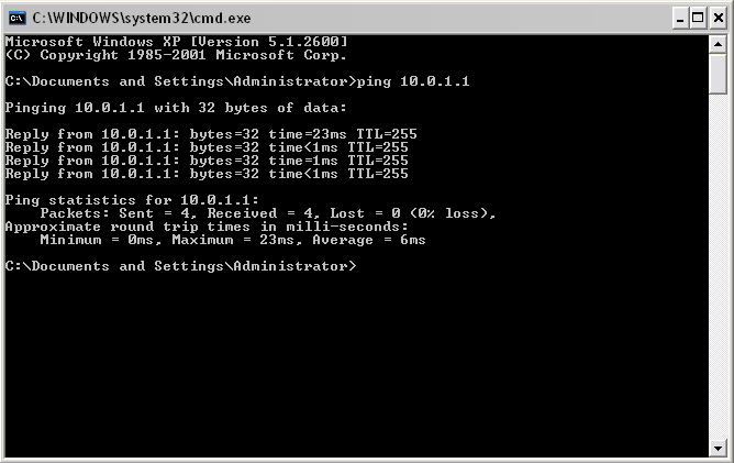

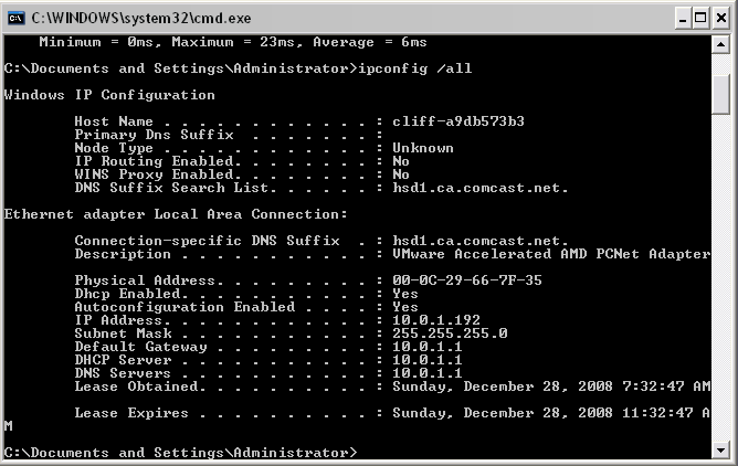

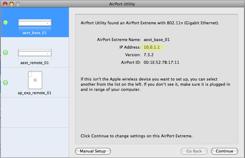

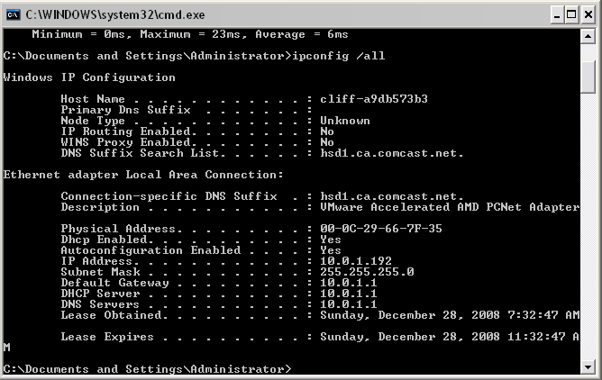

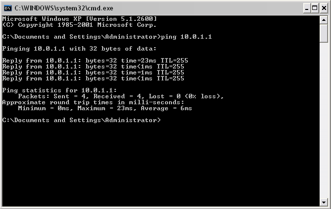

1. Open a command window by selecting Start > Run > cmd
2. Ping the router - you'll need to know the ip address - this is on the main Airport Utility screen (refer to attachment) - at the command prompt type ping n.n.n.n - in my case, it would be ping 10.0.1.1
3. If the router is not accessible, then the ping will timeout. Otherwise it will look like the attachment.
4. If the ping is not successful, them run ipconfig /all. The IP address is in the second block of text - in the case of my XP VM, the address is 10.0.1.192. If your PC isn't seeing the router, then the IP address will come back with 169.254.something.

Dell Troubleshooting
Thanks again Cliff3,
I don't have all of the information you are showing in the ipconfig response. There is no IP address info in the Ethernet adapter Local Area Connection: section. It also indicates that the Media State is "Media Disconnected". Does this offer any clues?
