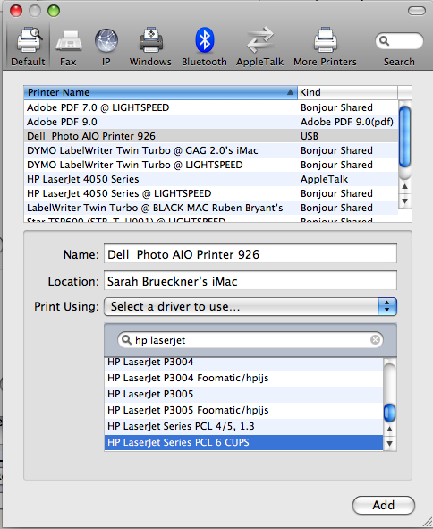

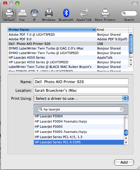

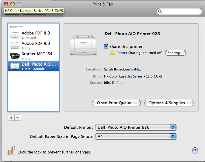

Hi there : )
I have almost got my Dell photo 926 working using your method. I managed to get the printer set-up without the Ip address. I did this under the 'default' option in system preferences (system preferences / print and fax/ + / Default)
However, now when I print, the job quickly shows up the print queue, but then disappears, never to successfully reach the printer.
Any ideas anyone?
(I have attached screenshots so you can see what I did)
