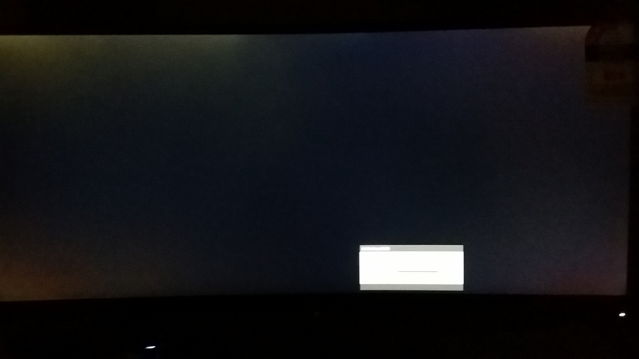

Got my second replacement. Not surprised that it's worse than the first. Oh well, let the waiting game begin.
I'm waffling on whether to send mine back or not. It's really bad in the upper corners, about as bad as your first one. But I'm also not sure how I feel about playing the backlight bleed lottery.
Also, the screen has problems waking up when the computer wakes up from sleep in OS X. (It does not have this problem in Windows 7.) Do you have any wake from sleep problems?
I don't mind if there's subtle backlight bleeding but I seriously can see that yellow glow while watching movies and it's extremely distracting. And no I don't have any wake up problems. i'm running on 10.9.5

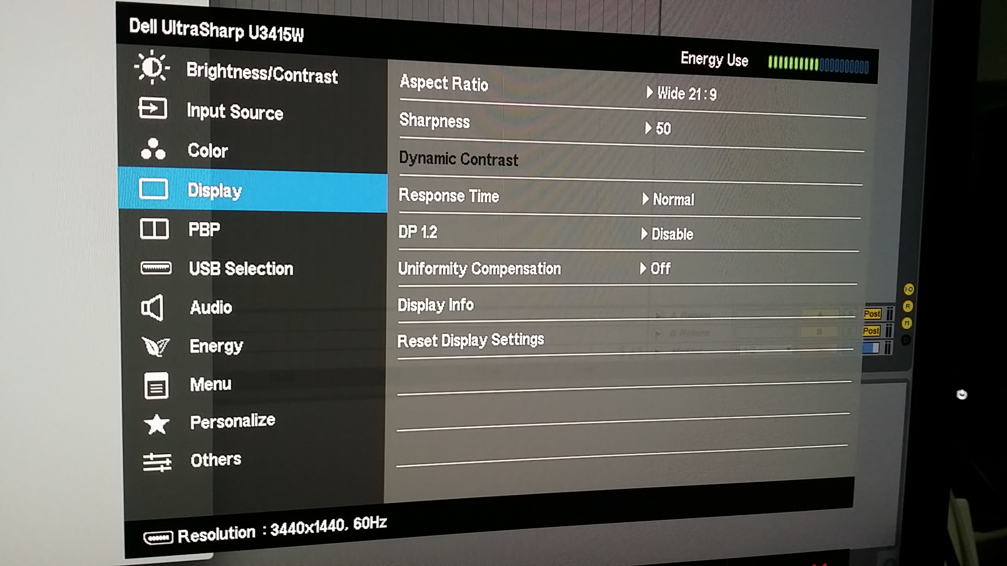

FYI looks like DP1.2 doesn't play nice with the nMP with D700 video cards using 10.10.2, screen goes blank with DP 1.2 enabled, DP 1.1 works fine when set using the screen menu.
Raised an Applecare call, ran the timingsnoop app and emailed them the results.
Looks like its a driver issue that they are going to try and fix.
The odd thing is my Mac Mini late 2012 works fine.
Great screen if you can live with the IPS glow.
works fine on mine. did you use the hdmi and turn off dp 1.2 feature? reconnect back with the mDP to DP to get 60Hz
Yup I used HDMI on my raspberry PI to change form DP1.2 to 1.1, but the screen goes blank after reconnection the mdp and setting the screen back to 1.2

I disabled DP 1.2 because it doesn't get me anything and doing so solves some compatibility issues. I turned the brightness way down because this thing is so bright it almost feels like my eyeballs are being assaulted.
You may have to "map" the upstream USB port to the appropriate video in port due to the way this monitor can be used as a KVM switch for two computers.
The Dell is factory calibrated, so if you mean color settings, I wouldn't change them to someone else's settings.
