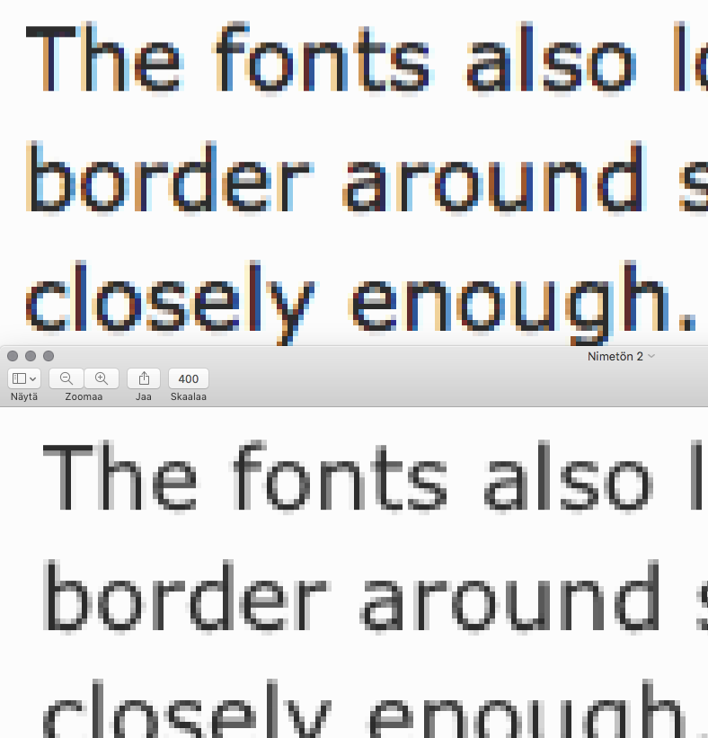

I just got my Dell U3417W and am amazed at how crappy the fonts look. Is this just because i've been used to retina or 4k screens? Everything is jagged and pixel looking unless i increase the zoom to 150%.
The fonts also look like they have a red border around some of the letters if i look closely enough. Even if i zoom to 200 or 300, i can still see the red. I'm guessing this is just a byproduct of not having enough pixels on the screen?
Is there any way to fix this? or at least get relatively better looking fonts?

You could try to turn of
System prefs - General - LCD font smoothing
if you are extra sensitive to that red and blue antialiasing scheme.
It will not change the jaggines though, see attached. Antialiasing just became grayscale.
I don't know if you can use pure B/W fonts anymore in MacOS. Earlier in OS X history you could do that.
