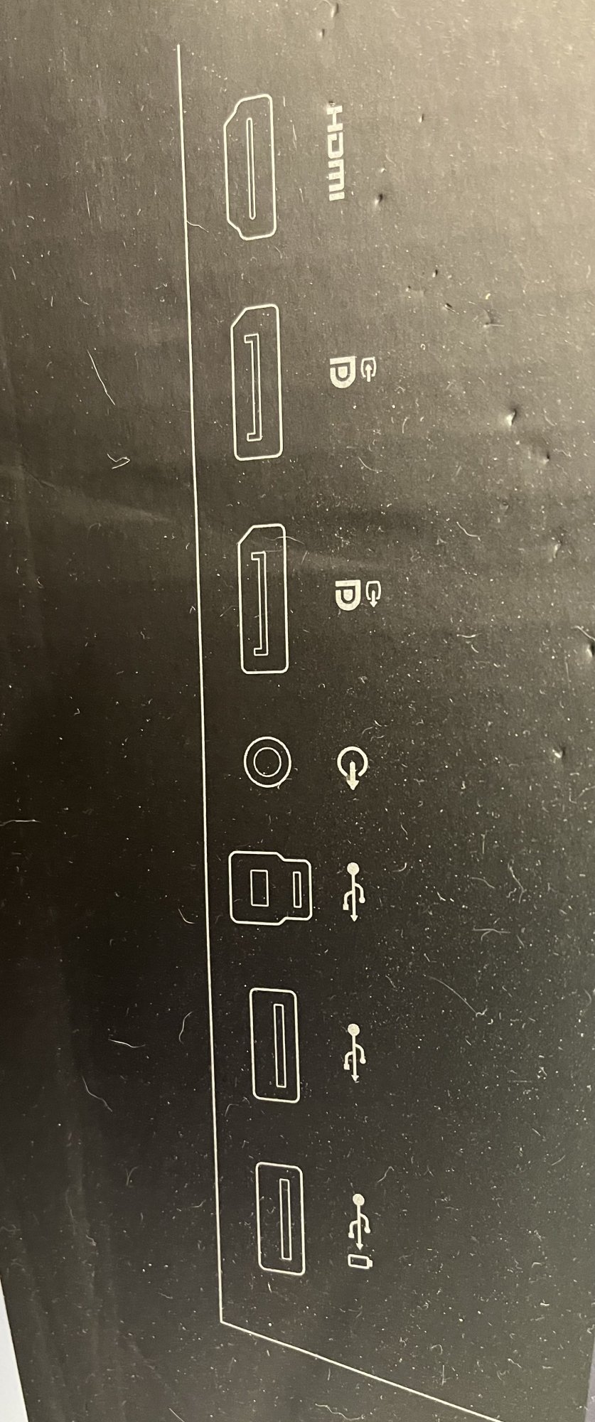

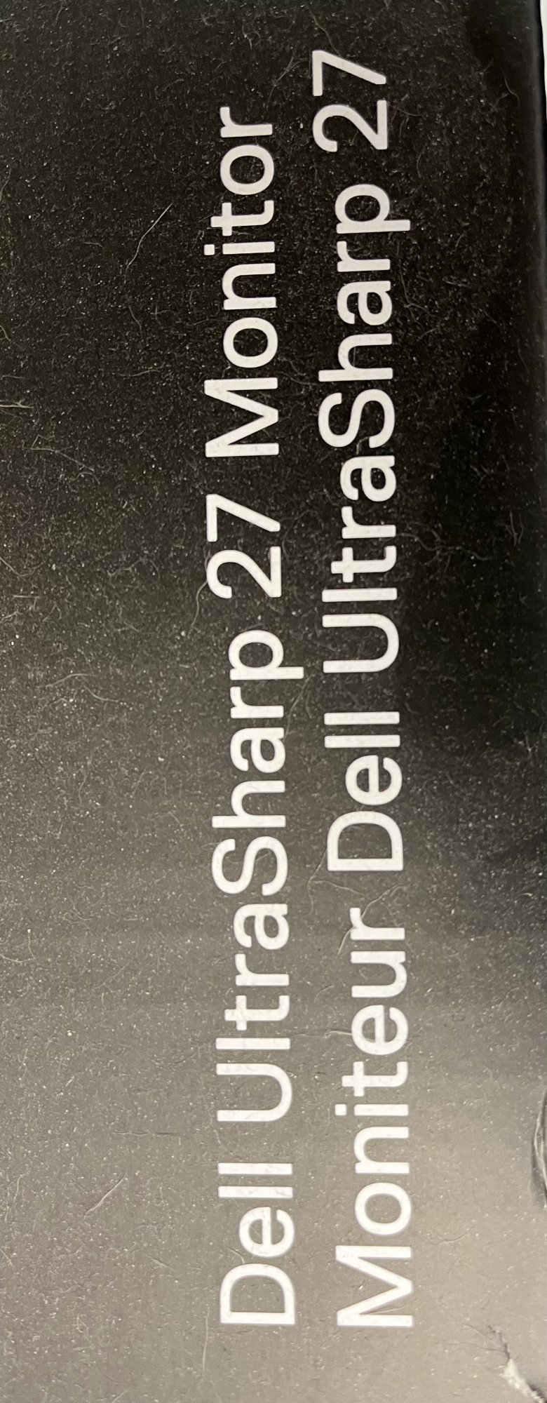

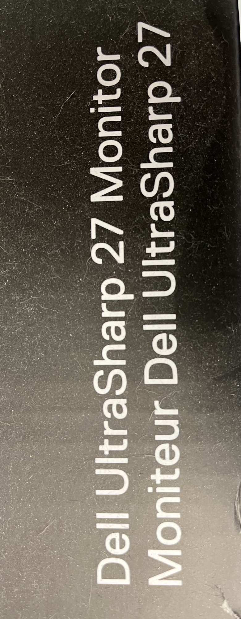

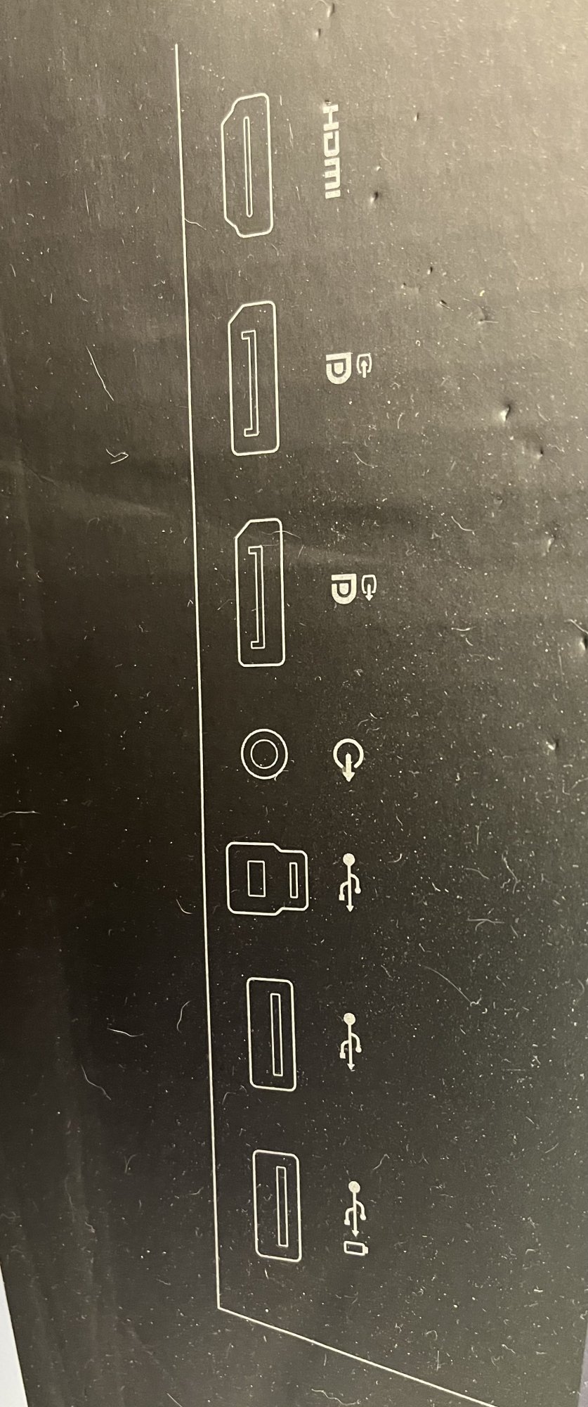

At work I am using dual monitor setup with a Dell desktop, and would like to get back to the Apple ecosystem at work.
Would these monitors function with the the M2 Pro?
Thanks for any technical guidance or experience you may have.
monitor model numbers would be more useful than those screenshots.
anyway, my M2 pro is very happy with my new dell monitor. if it's a recent model you're looking at, you should be fine. & you can always go to amazon and search reviews for 'mac' compatibility, or chat with dell on their site.
