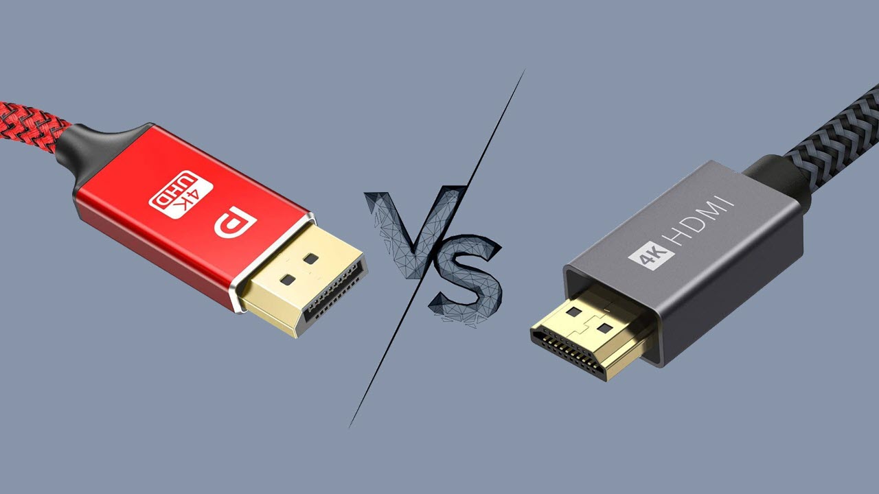

Is this actually correct? Because I am getting HDR even with HDMI. Shouldn't DP be at least equal to HDMI?

Went to store today and bought proper USB-C to DisplayPort cabel. This one to be exact. Can confirm that with this cable + Big Sur 11.2 I'm getting HDR. No RGB though. I think I'll keep this setup because I really need those extra USB ports on monitor :rolleyes:
Edit: And to be clear; the picture is great. I've switched it back and forth with RGB mode and can't see a difference. I had another crappier USB-C to DP adapter which did degrade the colors and didn't support HDR, but with proper cable I'm extremely happy with this monitor+M1 combo.

Dell just replied to me, and was saying that U3219Q is able to provide 4K at 120Hz with Display Port or HDMI, and 4K at 60Hz with USB-C.
They recommend using Display Port if possible. Did you guys saw such benefit by using Display Port ?
Reactions: Mistercharlie
HDMI 2.0 maxes out at 4K 60Hz. So Dell is saying bullsh*t.
DisplayPort has higher bandwidth. DisplayPort is always better than HDMI 2.0. USB-C uses DisplayPort.
Use USB-C-to-USB-C or USB-C to DisplayPort (it’s the exact same).
