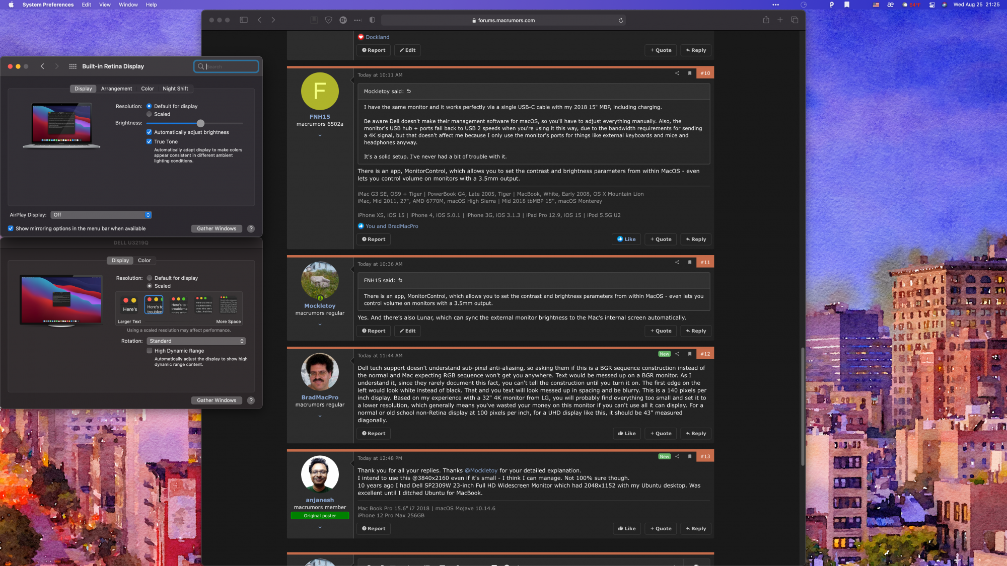

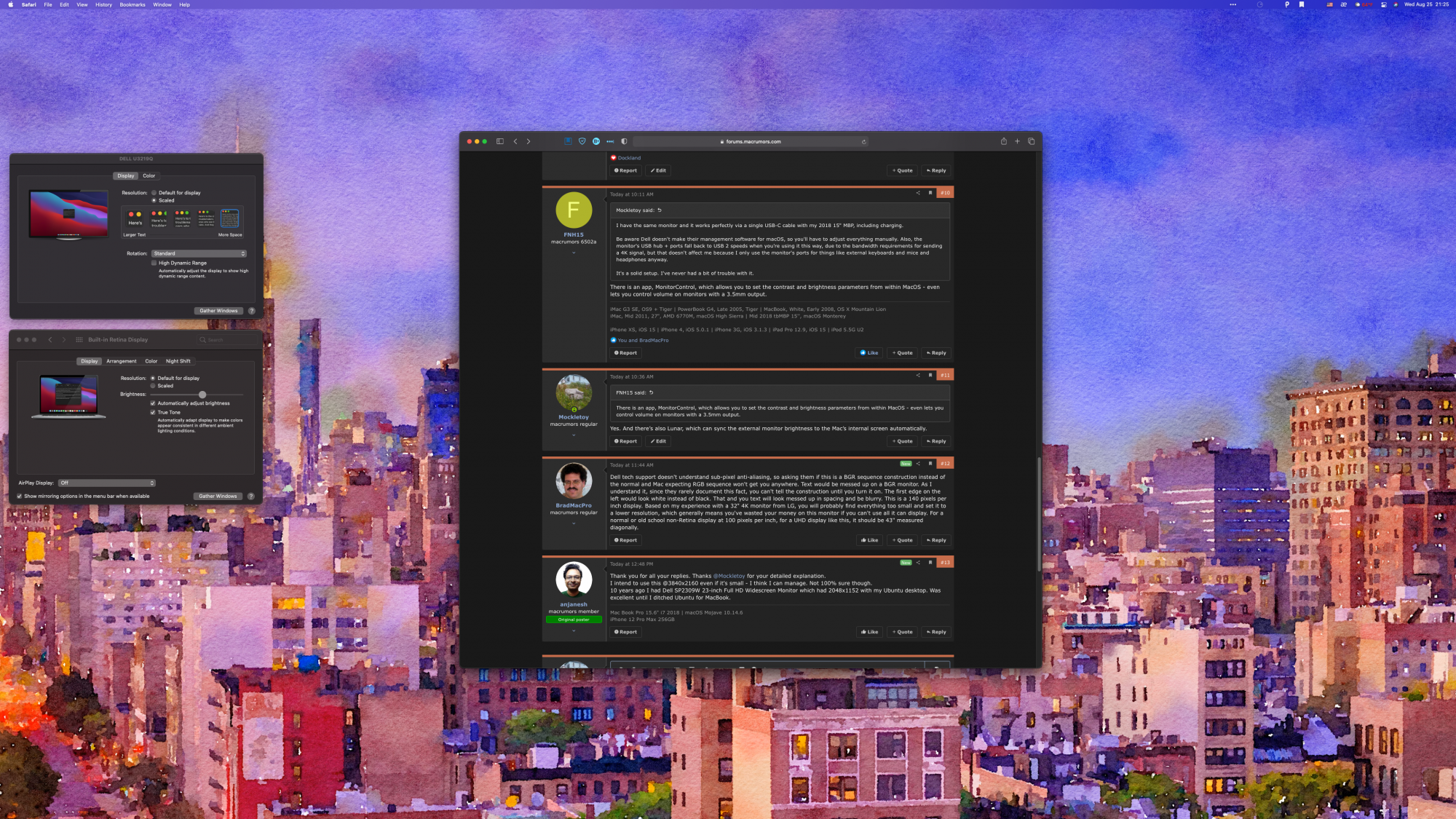

I snapped two screenshots. The Safari window is the same relative size in both of them, to give you some idea. One is native 3840x2160, the other is "looks like 2560x1440."
It's quite usable in full 4K, but I don't know if I'd want to squint at it all day long.
