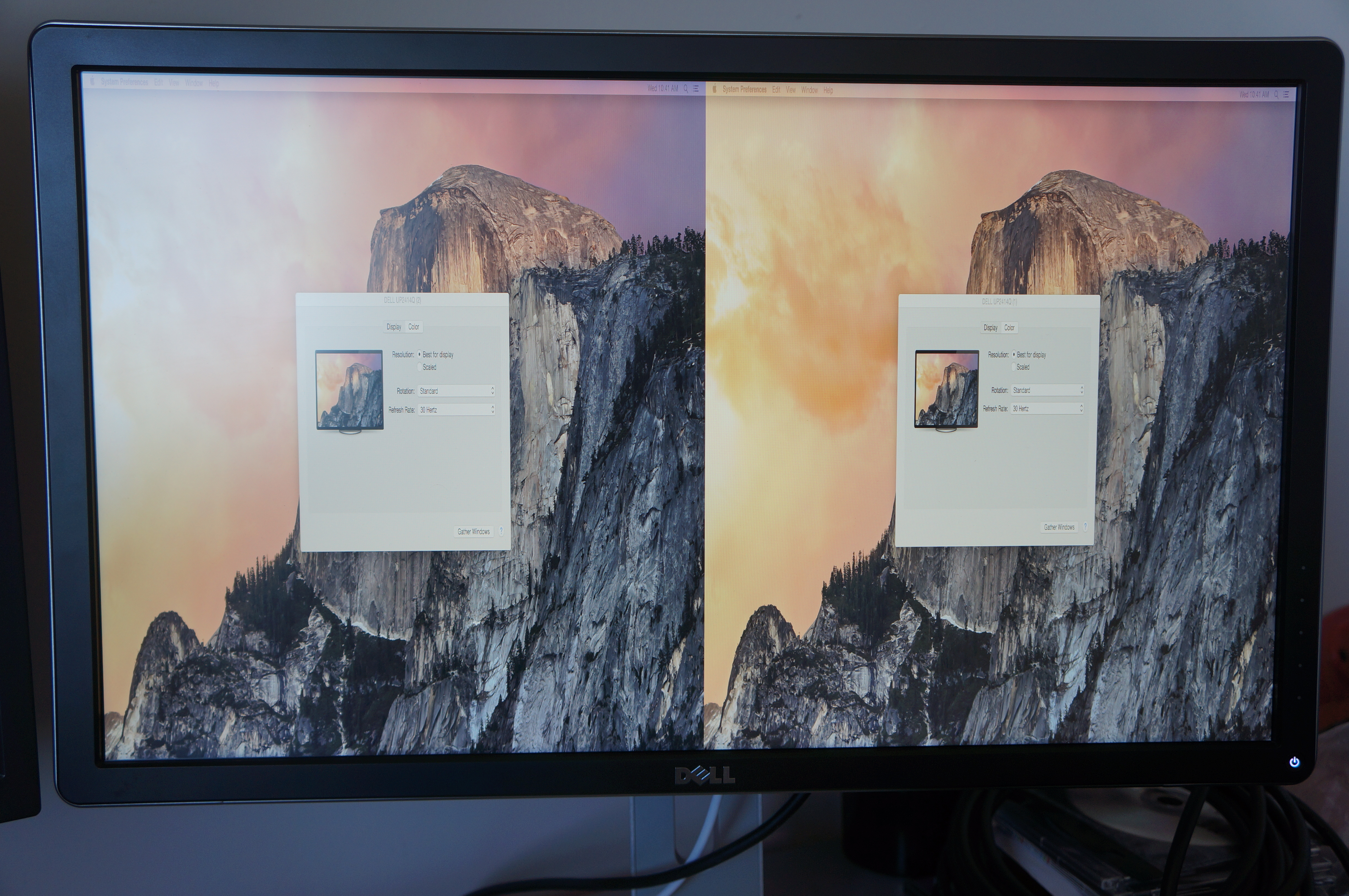

So I'm working on building a fast 4,1 for my work and one of the things I really want is a 4K display or two, so I picked up a Dell UP2414Q and a 7970 and flashed it with with the proper EFI.
However, when I boot my system the Dell display looks like this
Using SwitchResX I can set each "half" to 1920x2160@60Hz and it works except since the OS thinks it's two separate displays I have the expected limitations.
When I disable display port 1.2 it gives me 1 4K display at 30Hz, and when I boot into windows 8 on this machine I get 1 4K display @60Hz (with DP1.2 enabled) so I guess it's not a hardware problem.
Is there a way to force the system to recognize the display as a single display instead of two halves?

I have 7950 EFI with UP2414Q. also found this problem too.
Try everything, every method, so i gave up.
I change from 7950 to GTX680 everything works 4K with 60Hz.
Just suggesting.
Glad to hear I'm not the only one with this problem, but apparently there is currently isn't a (software) solution.
I'm considering an nvidia card since CUDA seems to be winning the GPU computing framework war but ideally I like to do it at my leisure instead of being forced to due to a software bug.
With that said will any DP1.2 enabled nVidia card work?
