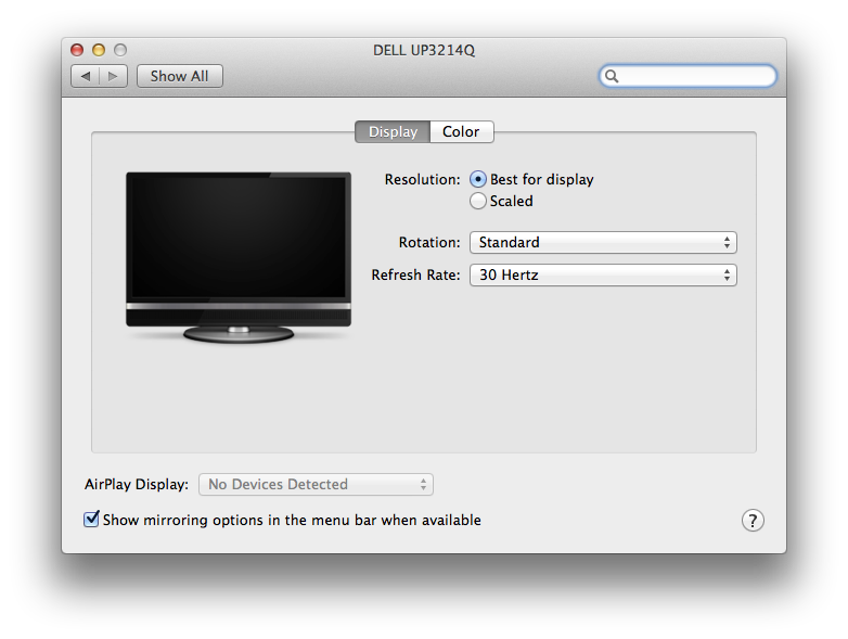

Not compatible currently, only works at 30Hz. It's likely that 10.9.2 will fix!

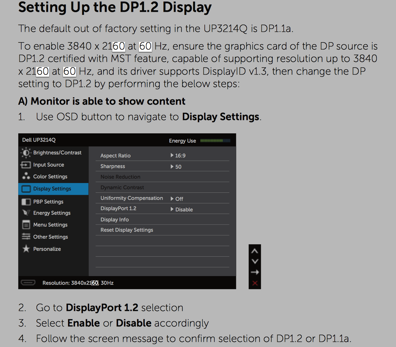

Assuming you have the above, did you enable MST mode on the monitor? 60Hz in 4K only comes via DisplayPort 1.2 running MST (dual stream) mode. On the Dell monitors, it has to be on the primary full-size DisplayPort connector.

Which manual?
the topic of the thread. 🙂 The UP3214Q:
http://www.dell.com/support/Manuals/us/en/19/product/dell-up3214q

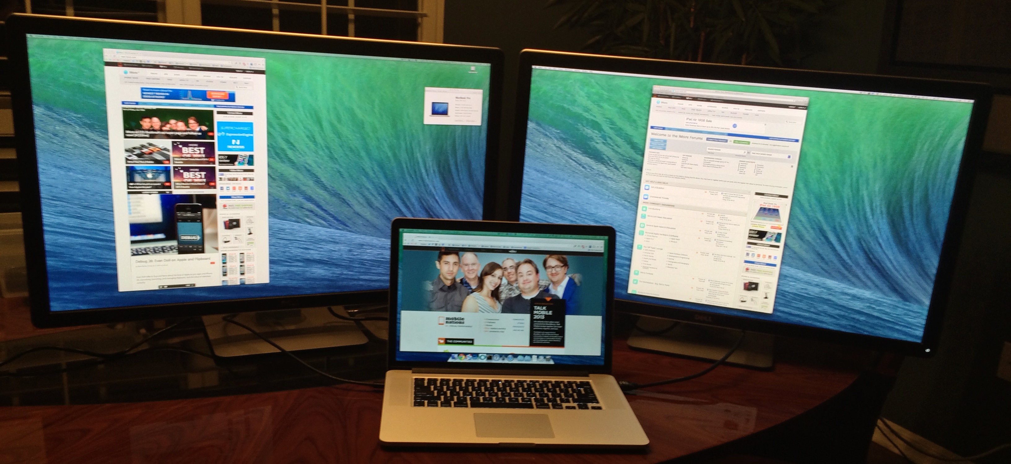

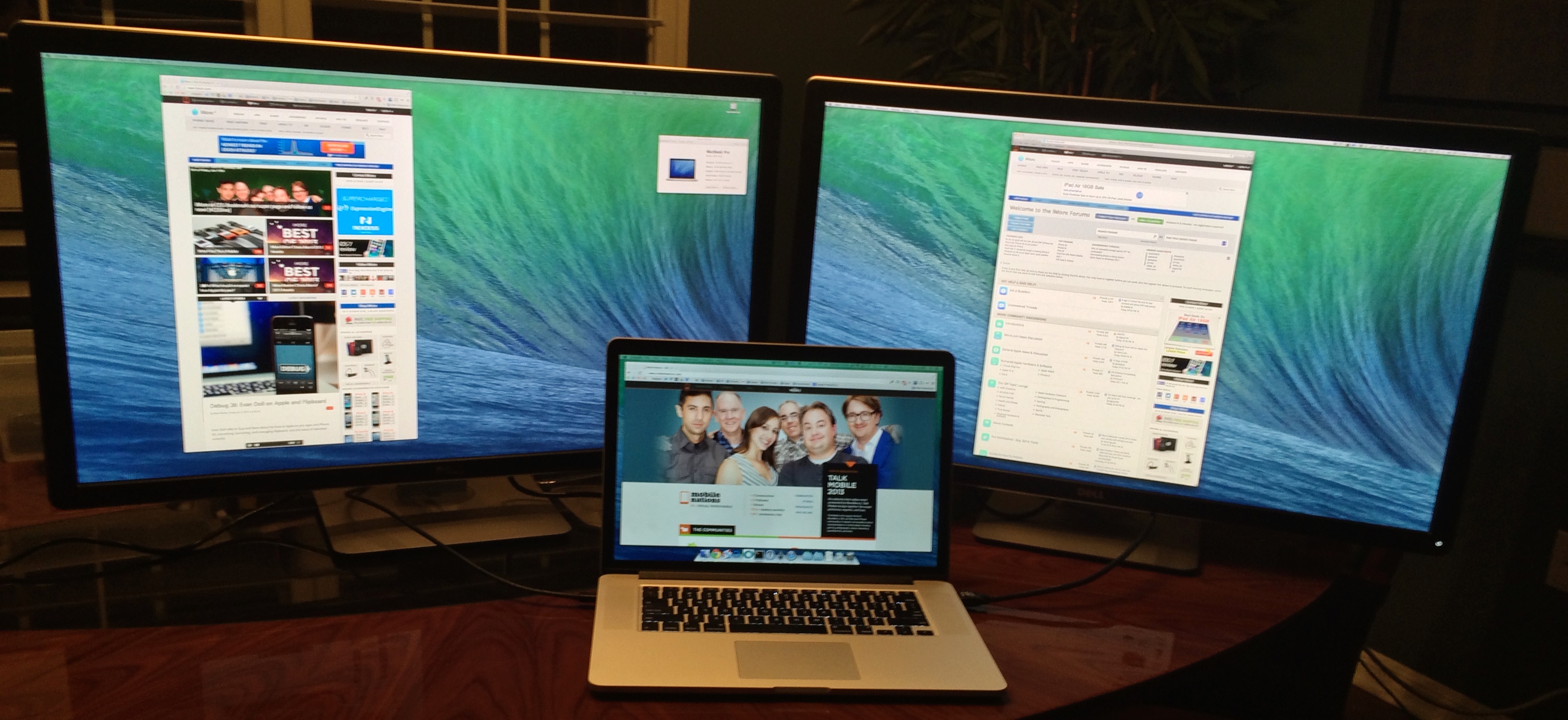

FYI the 2012 MacBook Retina can drive two 4k monitors at 30Hz...

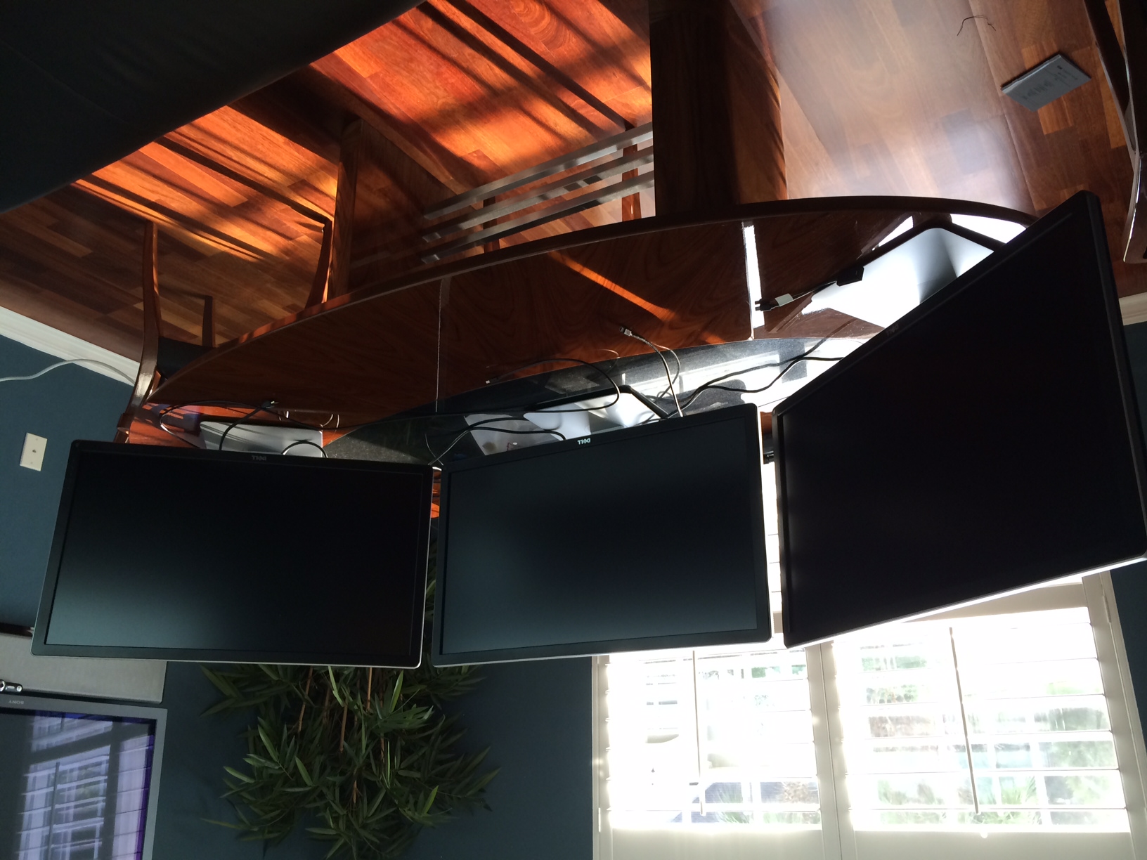

I got three of these dell monitors and Mac Pro was delivered today..
I can have all three running at 30hz, I've connected them as they indicate in their user guide thing.
Problem is when I enable display port 1.2 on the monitors, the screen just goes fuzzy and looks like it's at something like 1080.
Not sure what to do...?
So frustrating when I've just spent around £15k on all of this setup!
