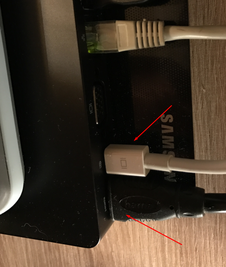

In my setup, the video works from both the HDMI port and the miniDP port, but they are mirroring each other only.
The small LED on the USB-C connector is not on when it's connected to the Macbook. It is on when it's connected to the XPS 15.

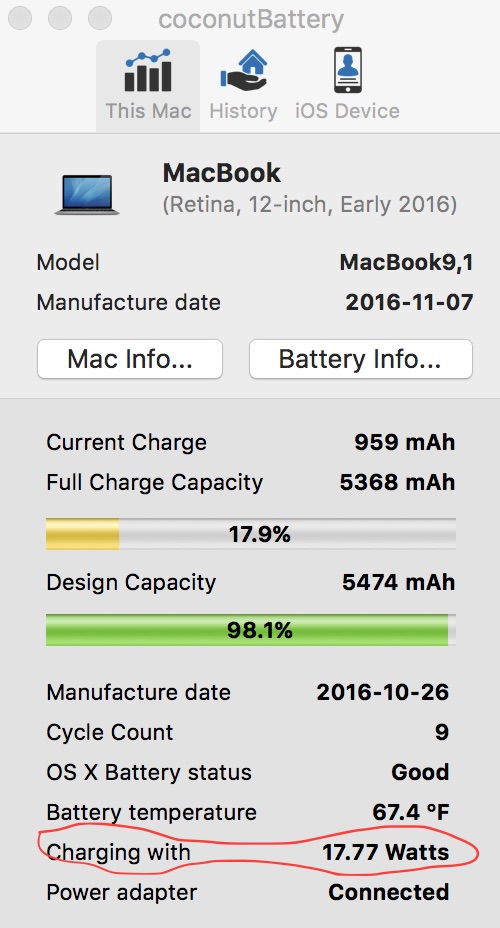

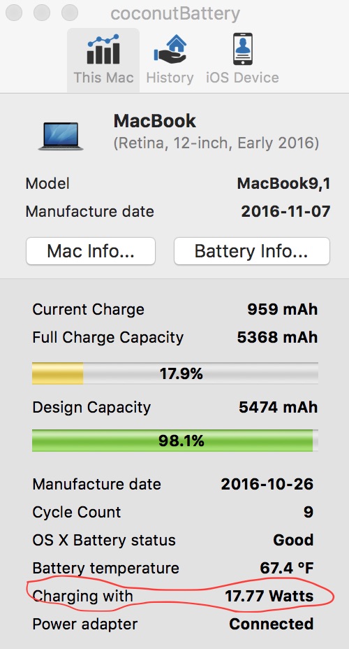

I use coconut battery to tell me how many Watts it's charging.

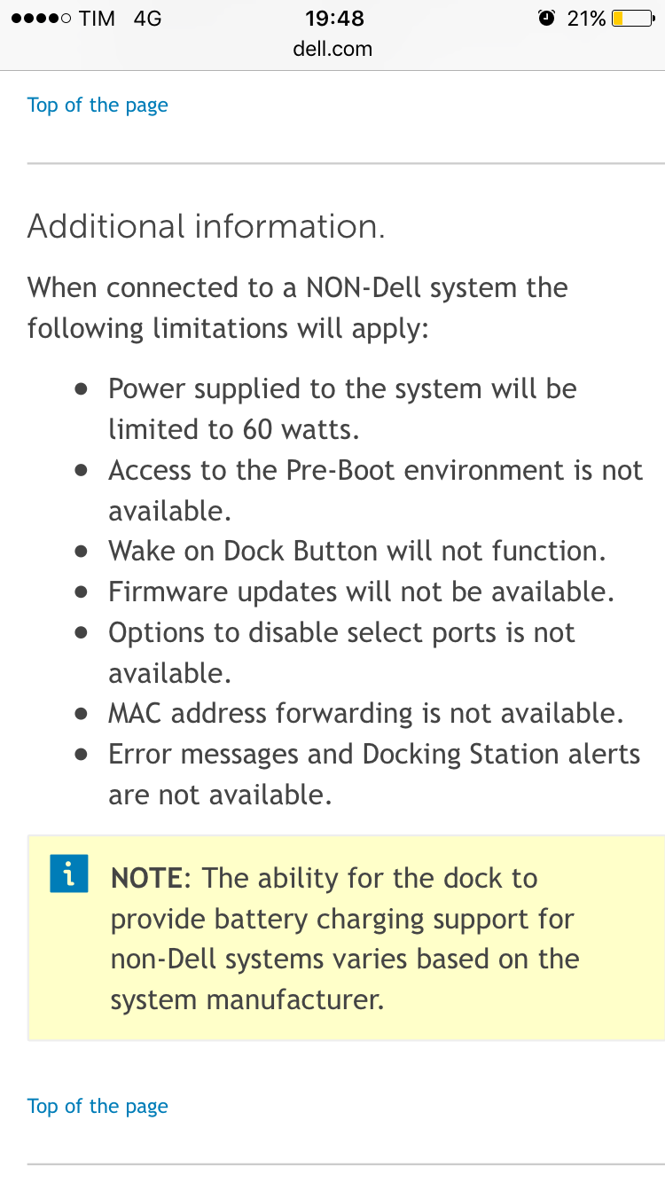

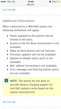

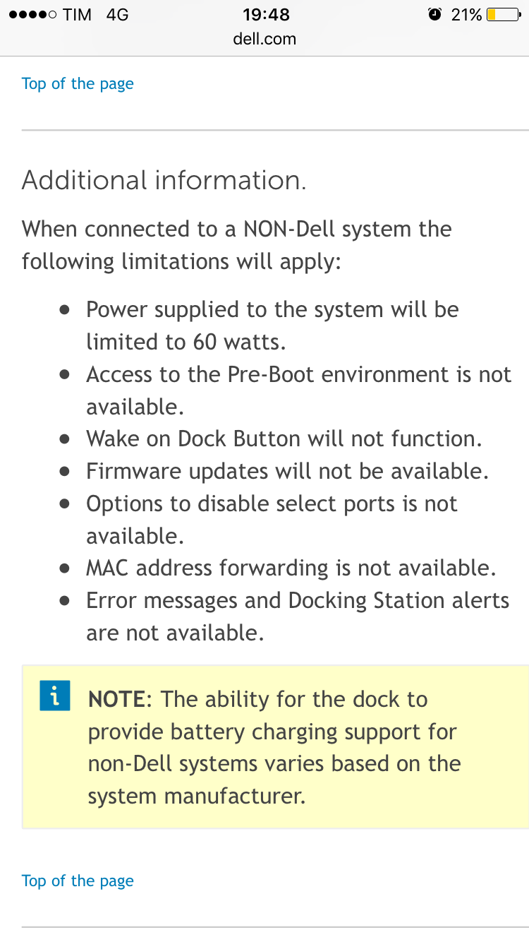

Going through the dell website I've found this note:
which probably explains that it is normal that the led doesn't light up.

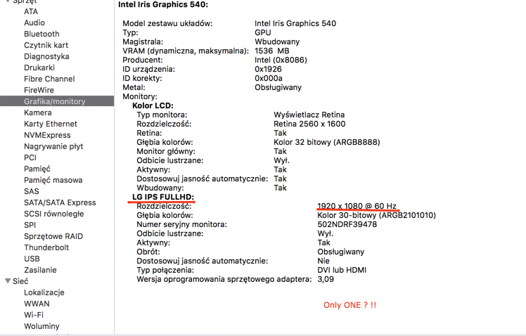

First of all, Dell WD-15 never recharge your mac - no drivers, no charging, Dell forgot to mention ? Och dear !
Second, You never get 2 separate workspaces by connect 2 FHD monitors - the only thing that You can get is Screen Mirroring, no drivers, no separate workspaces, Dell forgot to mention ? Och dear !
So what really happens, when you connect 2 monitors to WD-15 ?
Nothing ! 🙂 OS X System Spec's show's only one monitor !
How come ? There are 2 connected monitors ?
This method also does not work:
https://github.com/KhaosT/tb3-enabler
So, You can use WD-15 with new Macbook Pro 2016, if you do not care about 2 monitors.

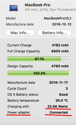

The WD15 charges the MacBook at about the same rate as the Apple charger (17.77W vs 18.20W).
Your MBP should charge at higher rate as shown on your screen shot.

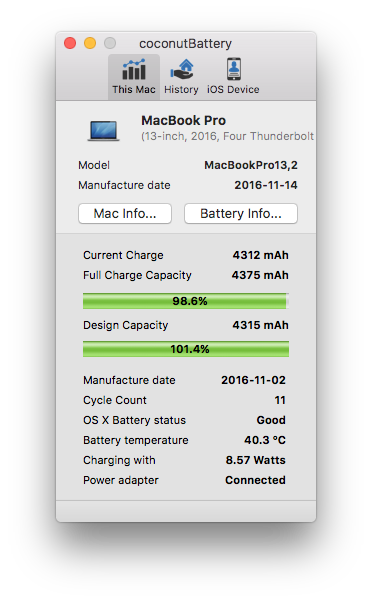

[doublepost=1483772482][/doublepost]Well I just checked my charge rate and its only 8 Watts...? I wonder if thats causing the issue of the USB ports dropping out. Could this be a power issue from my house? or a faulty WD15? I'll run a test on my office wd15 and see how that goes.

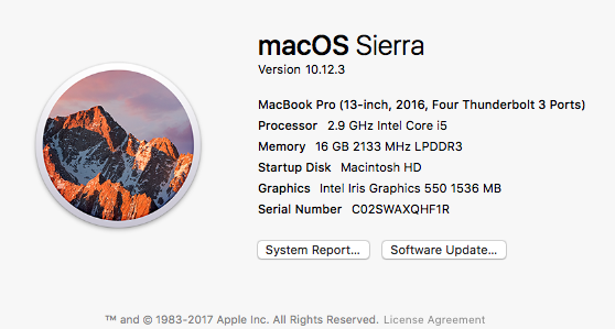

Just throwing this one out there:

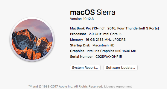

Sierra 10.12.3
MacBook Pro (13-inch, 2016, Two Thunderbolt 3 ports)
Nixeus Display Port ONLY display: NX-VUE27D
USB and Ethernet worked right out of the box.
Laptop charges and runs totally off USB-C once battery is full.
Have not tested audio.
Getting the display to do anything other than 1280x720 required creating a custom SwitchResX profile @ 40hz. (running the native resolution of 2560x1440)
Overall I am satisfied.

Is this still true after the latest firmware updates for the WD15? I am considering the same combo (12" MacBook -- Dell WD15 -- ACD 27).
At present, I have a 2016 MBP and Apple Thunderbolt Display but for various reasons I want to downgrade both...
