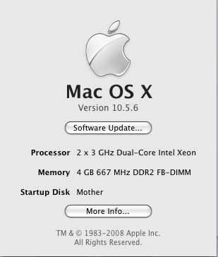

Can you grab a screen capture of your "About this Mac" System Profiler?
Be sure to blank out your serial number on the initial screen before posting.
Then a grab of the Graphics/Displays and the PCI Cards as well.

I personally attempted to acquire the video card firmware and got the message stating it was not needed.

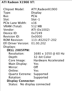

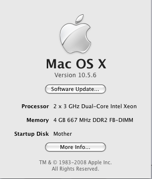

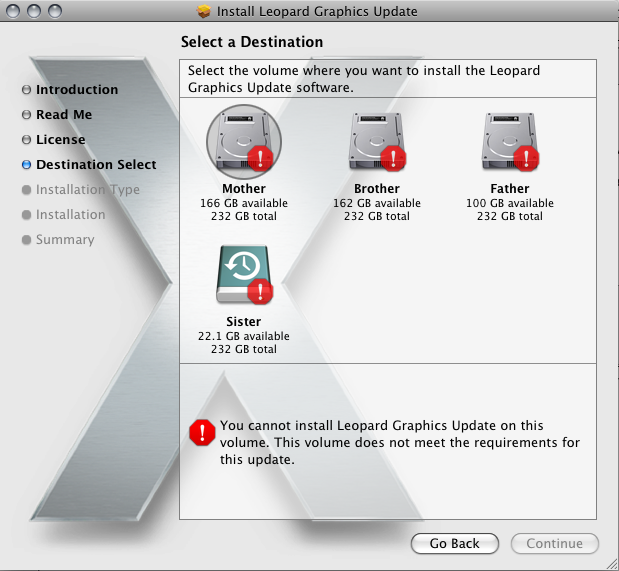

Also...I think I should note that i took those screen shots with TWO dell 2005fpw monitors connected, not just one.

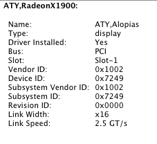

After trying to download the leopard graphics update, I got this screen. (because my computer hates me and wants to find a new home on craigslist)
The MacPro is telling you it doesn't need the update as it is already installed.

Thanks for the research. unfortunately all those threads are painfully familiar to me. sigh read em already.
Believe it or not, I AM still using that cute little yellow tag cable. Because there was no improvement with the new one I bought.
I'm at the point where I wanna send it back to dell for an RMA.

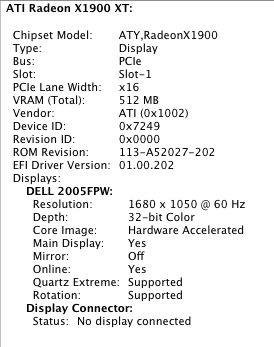

Have you used the 30" and the 20" together in a dual monitor setup with both monitors connected at boot?
Do a Safe Boot which disables all the Extensions by holding down the SHIFT key at startup. I usually just hold it down till the logon screen appears.
Does the 20" boot and display the desktop?
I assume the 30" does not display the desktop or anything else, but is the amber stand-by light on?
If this is occurring try switching the cables on the DVI ports from the video card 20" to DVI port using 30" and vice versa while the MacPro is running.
Does the 20" still show the desktop?
What if anything on the 30"?
Next just disconnect the 30" from the DVI port on the video card.
Does the 30" now display anything when totally disconnected but still powered?
I read somewhere that the 30" displays various colors when their is no video source connected.
Have you tried to boot the MacPro from the OSX install disc with just the 30" connected? Perhaps something in the Hard Disk boot is causing the issue.
Just hold the "C" key down at boot to bypass the startup drive.
BTW if the "C" doesn't work try CMD-OPT-SHIFT-DELETE.
If you have TechTool Pro you might want to run the video test, hardware tests, as well as clean up the permissions et. al.
See if you see any signs of life.
When you were at the Apple Store did you hook up your MacPro with the new video card to an Apple ACD 30" and did it work?
Perhaps they'll allow you to bring in just the Dell 30" and use one of their MacPros to see if it works.
Apparently you are in LA. I am in Huntington Beach and I take all my non self repair mac hardware issues to LA Computer in Anaheim. Great People and reasonable.
Let us know if any of these ideas help, but if it is a monitor issue we are all just spinning our wheels.
