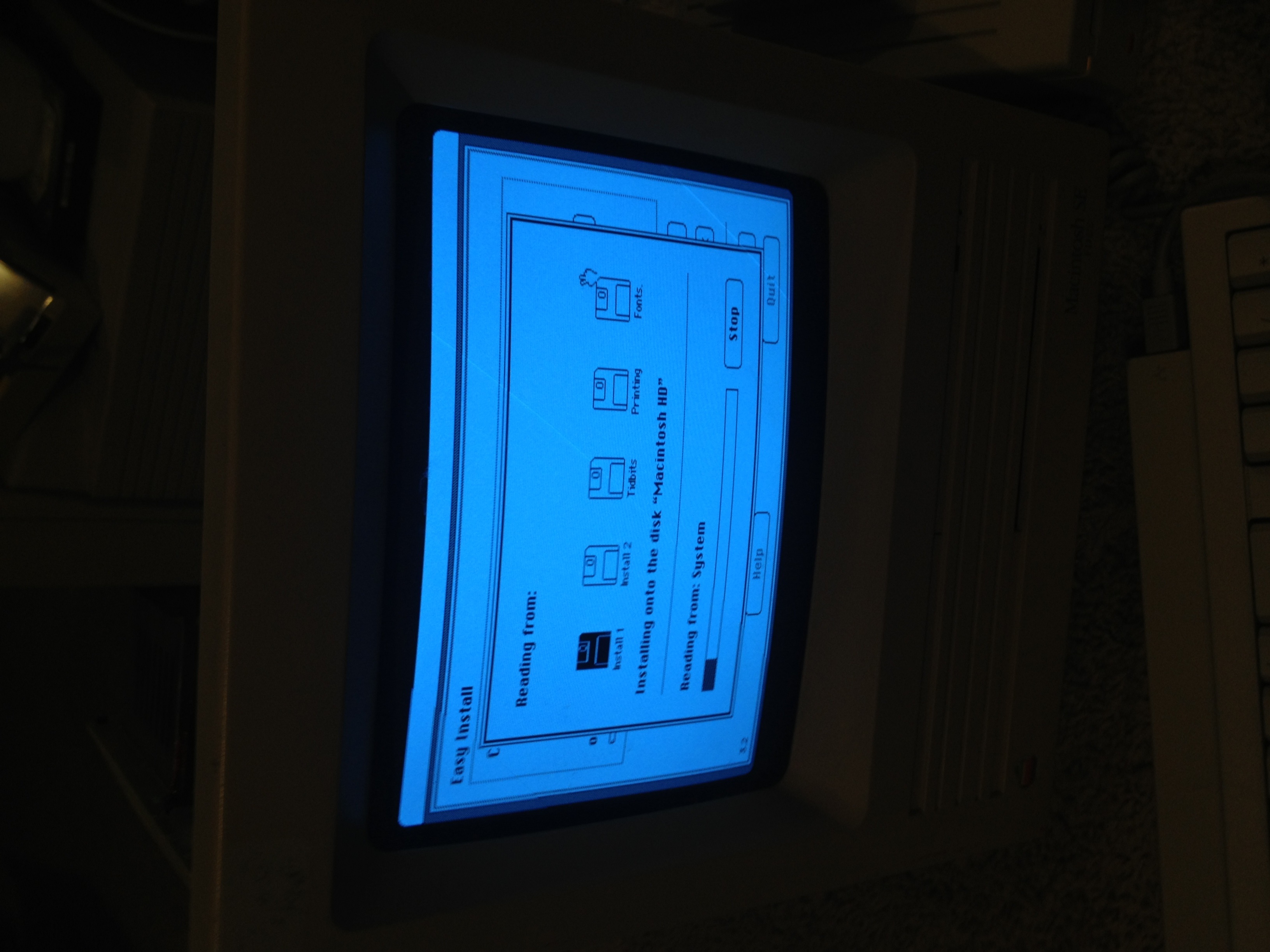

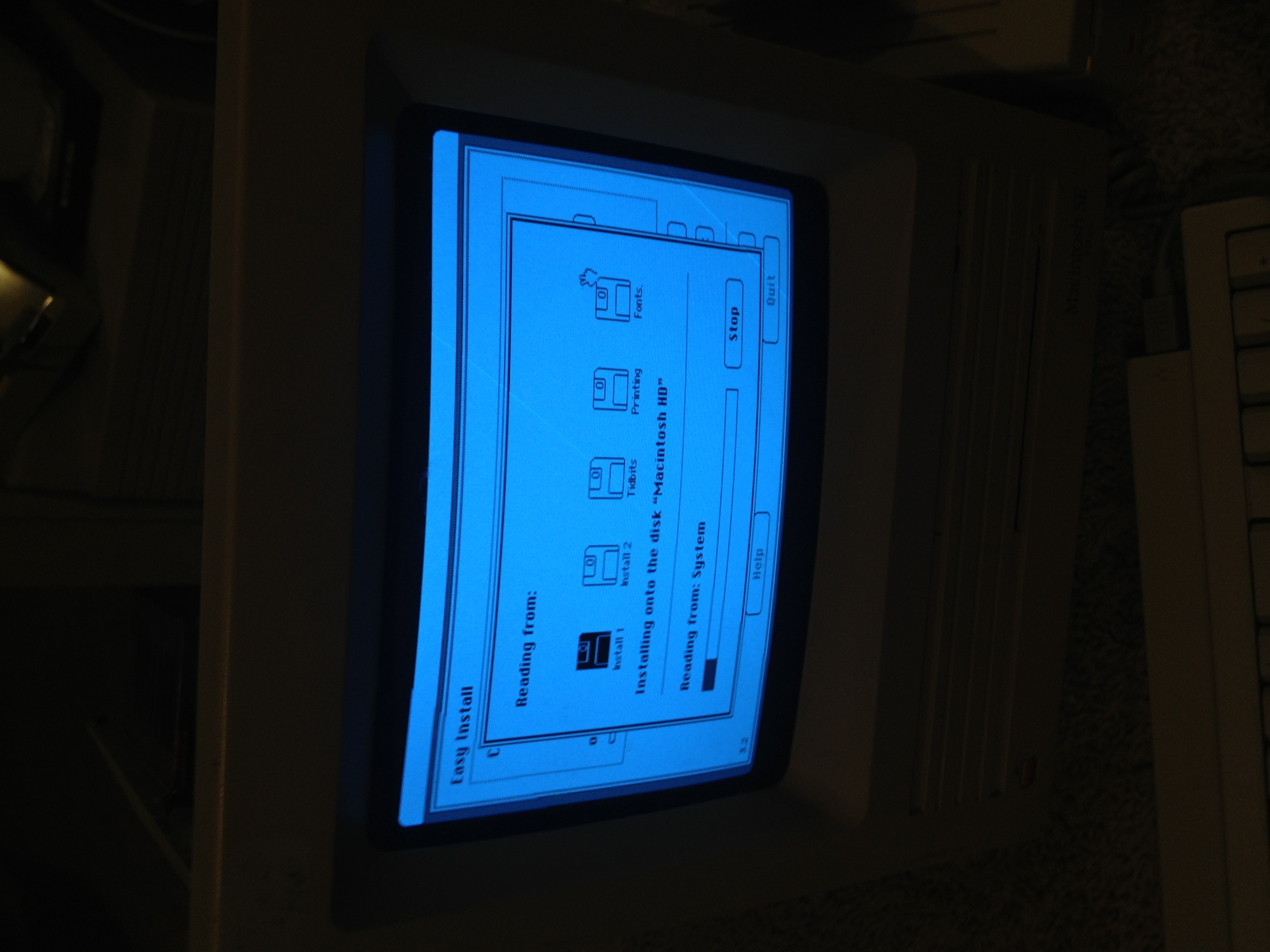

My curiosity got the better of me(if nothing else I figured the DeOxit would help me on my Zenith Trans-Oceanic radio).
In any case, I gave the SCSI socket on the logic board a squirt of it then connected/disconnected the cable several times as per the instructions.
I have System 7 installing at the moment. Unfortunately, the internal floppy is dead(I need to try and rebuild it) but in the mean time I have an external that's working great.(If anyone could point me toward an online guide to rebuilding the SuperDrive, I'd be most appreciative).
