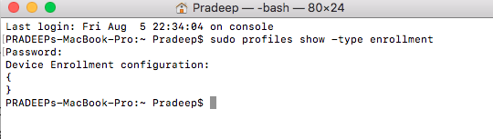

When I try to check the device enrollment configuration detail its showing just black brackets instead of Null or No device enrollment.
Is it normal or whats the reason for black brackets? Please check the attached image.
Using for my personal use - Bought used - Is it still linked to the prev persons company through device enrollment?

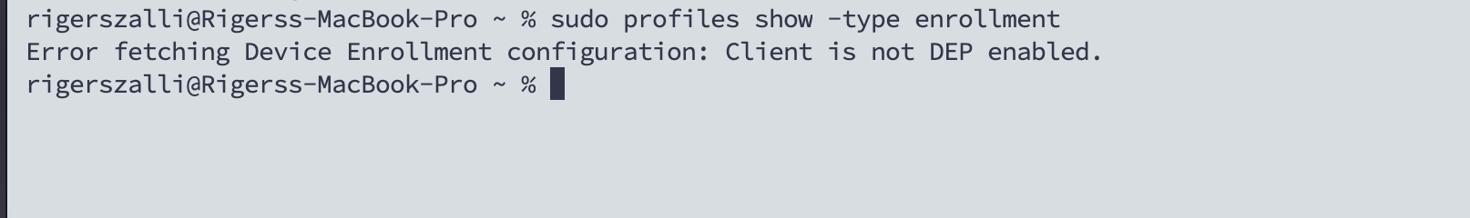

On Big Sur, not enrolled,
Code:
sudo profiles show -type enrollment
returns
Error fetching Device Enrollment configuration: Client is not DEP enabled.
and
Code:
sudo profiles show
returns
There are no configuration profiles installed in the system domain
Code:
returns
and
Code:
sudo profiles show
returns
This is high Sierra. And the sudo profiles show retured
So I believe the -type enrollment resulted in those brackets and can be ignored?
Yes, that is what returns in a High Sierra virtual machine that has never been enrolled.

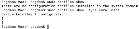

hey, i hade a mdm mbp as well and kinda scared to update it,
but differently, i'm in monterey and the command displays this
does this mean it is enrolled or not, as checking the serial number online, it has applecare+ but i do not know, it was a new laptop that i bought, so maybe stolen from a company, the shop told me it was mdm enrolled, but i cannot find anywhere any trace of mdm profiles, it does have the hosts hack, and i'm too scared to reset it
but differently, i'm in monterey and the command displays this ...does this mean it is enrolled or not,
Just like on Big Sur (see above), that is the response for a Mac that is not enrolled.
