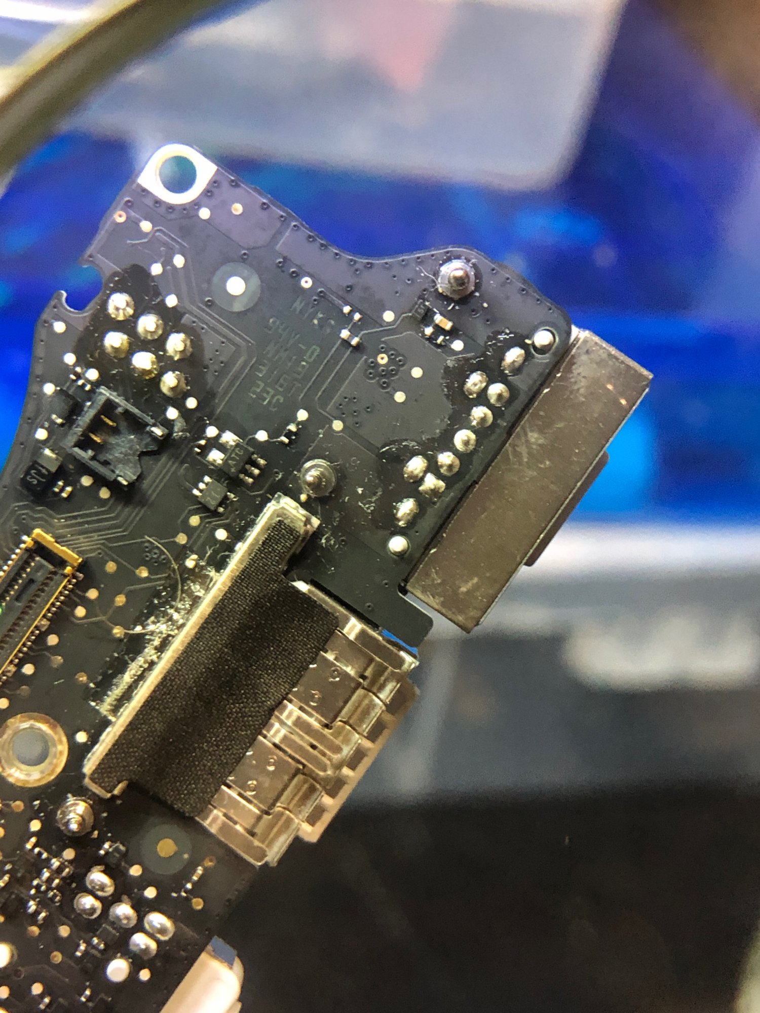

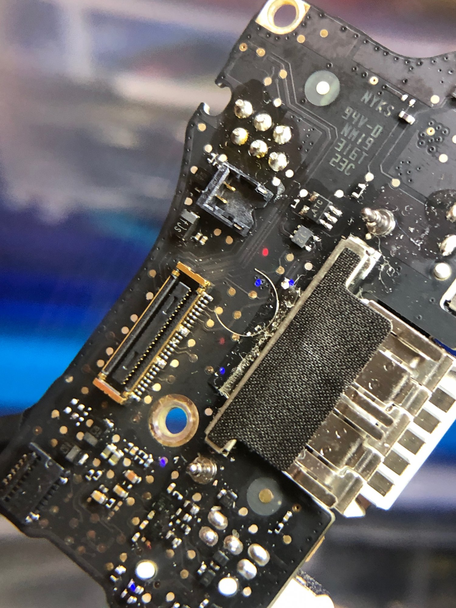

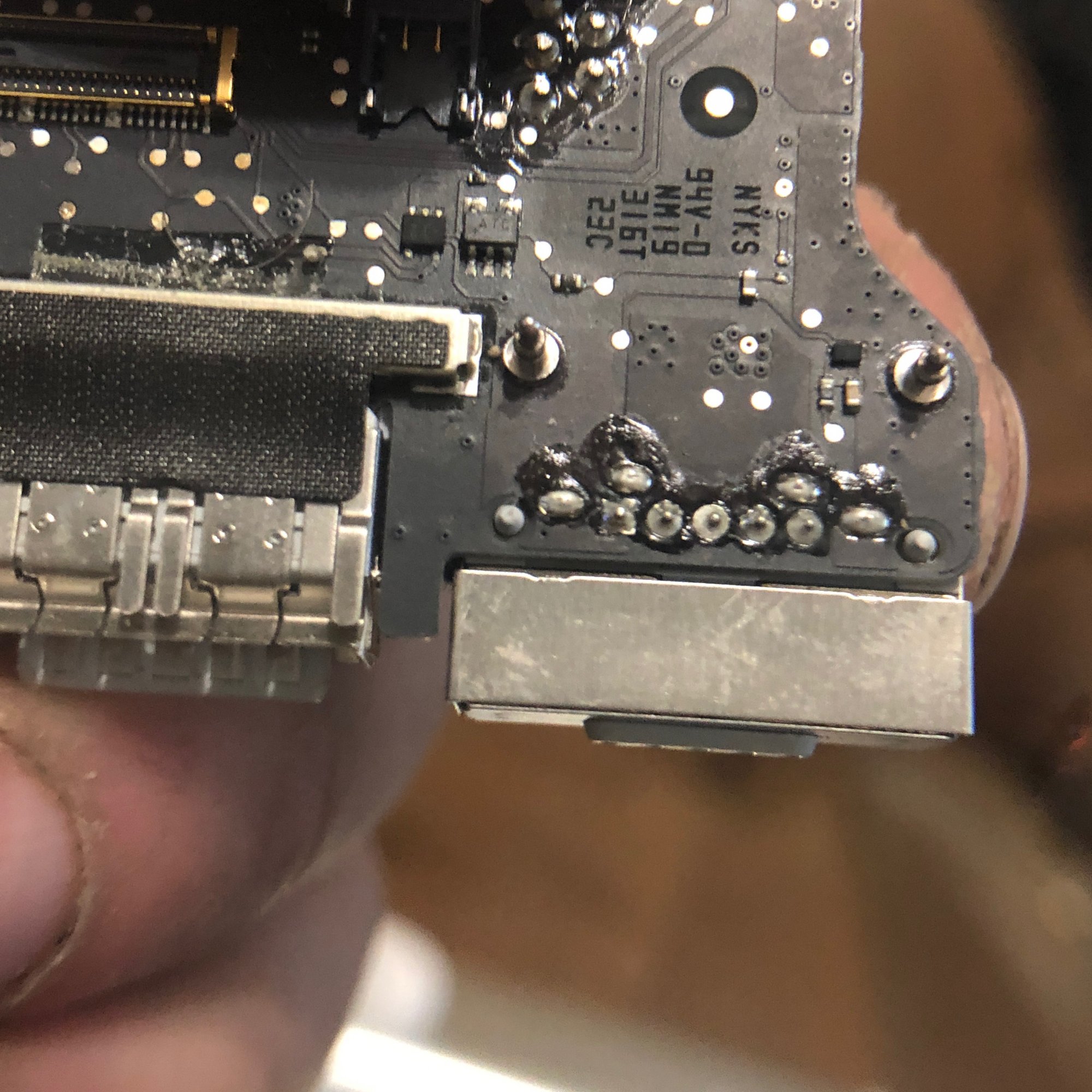

A friend of mine had me take some photos of the IO board to see if he could figure it out and isn't sure but seems to think there might be something up with that? I've attached those photos here but soldering and electrical work is far beyond my skillset.

I think the most likely cause is a dead battery. Question - when the computer was used regularly, was it often/always connected to power? If so, the battery almost certainly needs replacement. I've had to replace an MBA battery with less than 300 cycles, was about 3.5 years old, and was nearly always connected to power. Batteries don't like constant power connection.

It was connected fairly often but I was pretty good about disconnecting once it was at 100% especially if I was done using it for the day.

Yes, it was often connected to power but I was pretty good about making sure it wasn't left on charge too much once it was back to 100%.
