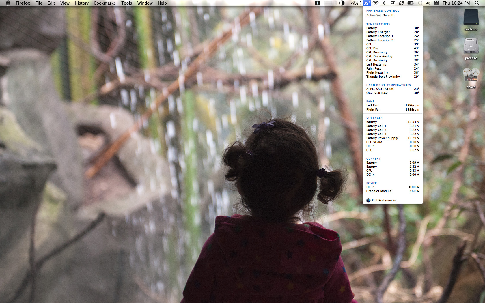

My Vertex 2 is at 30'C. My Apple SSD in my optical bay is 25'C.
128'C is a problem. Something is hosed.
