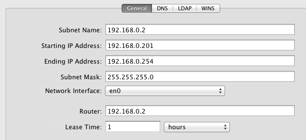

This is my nat setup I'm not sure this is correct.
Code:
nat on en0 from 192.168.0.0/24 to any -> (en0)
    pass from {lo0, 192.168.0.0/24} to any keep state
attached is the DHCP settings.
Code:
