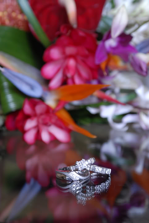

I posted this shot in the November thread for the hell of it. Ambient sunlight, no flash as mentioned. This came from the JPEG, I'll notch down the exposure on the RAW in Aperture before I post the pics online for the couple. Is this more or less (sans the reflection) what you're going for? I've got over a hundred examples on my hard drives, but as mentioned, post what you have so far...
EDIT: Same JPEG, slight Levels & Shadow/Highlight adjustment and a little Smart Sharpen filter on a 78% opacity merged layer. Not happy at all with the resulting artifacts in the surrounding reflected flowers, so I'll definitely work the RAW a bit, but I guess in part what I'm trying to show is that if you don't have exotic flowers in your shot the Smart Sharpen filter can be very helpful (or if you do I guess it's nothing the Art History brush can't negate).
great job, mattw126! i really love it.
Thanks, this is a somewhat typical arrangement of the three rings shot on a glass table. I have some more 'creative' compositions from many a wedding. That to me is half the fun of wedding photography - coming up with new ideas on the same themes and executing them correctly and quickly.
