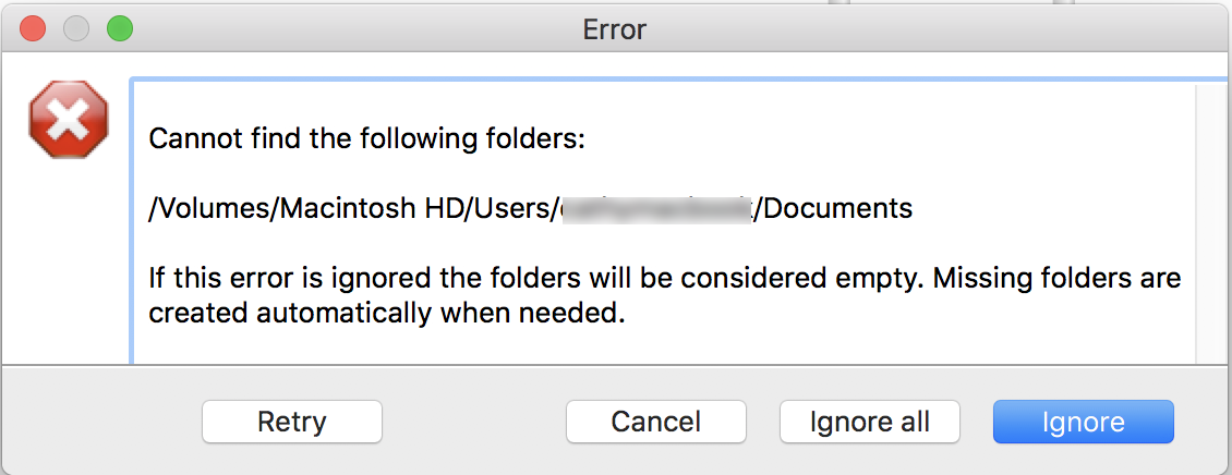

I’ve recently gone from Windows 10 computers to a Mac environment. I’m trying to set up syncing folders and files between an iMac and a MacBook Air with FreeFileSync. When I shut down both devices and start them again, and try to sync to the Macbook Air over my home network, FreeFileSync shows me the attached message. I have to re-enter the path to the MacBook Air to sync again. Both my iMac and Macbook Air each have only four sync jobs: Documents, Pictures, Music, and Thunderbird. When I re-enter any one of the sync paths to the MacBook Air, the others then work, but I have to re-enter any one path to get the others to work.
The problem also occurs when I use another sync program, so I’m thinking the problem could be a MacOS setting I missed. Can anyone speak to this problem? Thanks.

Odds are after the reboot the network drives will need to be remounted before running the sync. If you reboot and then manually mount the network drive and then run the sync does it run without error?
Thanks, AlumaMac. After a reboot, I enter the location manually in just one of the save jobs and they all work again just fine.
Ok, I just ran a quick test using FreeFileSync and experienced the same issue. Here is a workaround that worked for me.
In my scenario I was syncing a folder from my Macbook to my iMac, running FreeFilesync on my iMac. On my iMac I needed to re-mount my Macbook volume on the iMac after reboot. FreeFilesync was looking for my Macbook but it wasn't mounted because of the reboot and hence it errors out. After remounting, FFS worked without error and with no need to re-enter the path. (When you were reentering the path in FFS, you were re-mounting your MacBookAir and thats why it worked going forward.)
To fix, you can either manually mount your MacbookAir in the Finder after reboot, or set it to automount by adding it to your login items. Let me know if you need assistance with either of those solutions.

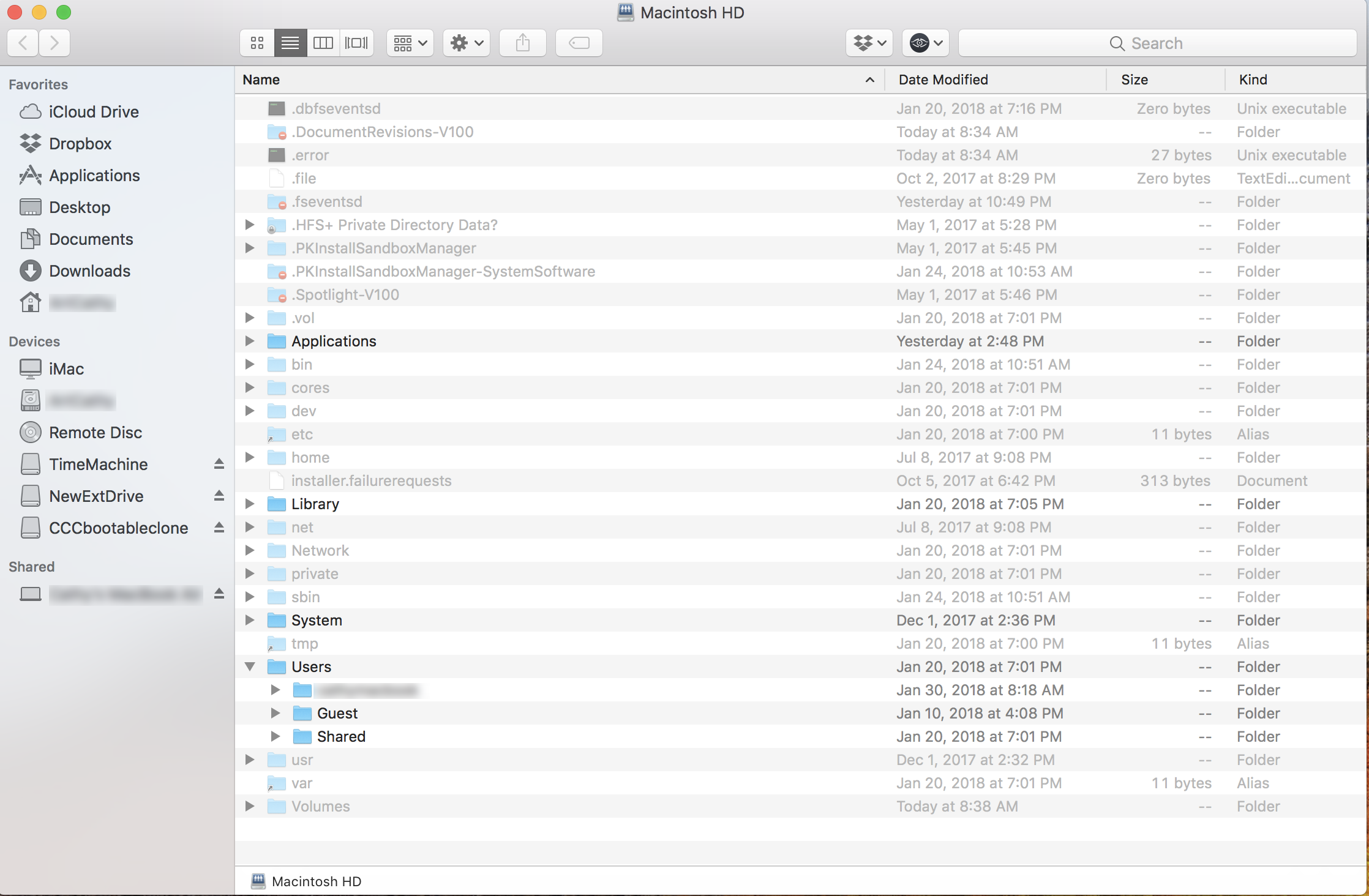

I see that when I start up my iMac (having booted my MacBook Air first), the Macintosh HD listing of the MacBook Air displays on my iMac. In Users & Groups > Login Items, I have checked "Hide" for the MacBook Air listing, but it still appears. Did I miss a setting?
Hmm, this used to work, but after some research it seems that the "hide" box ignores Finder windows. Sorry about that.
