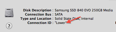

If you are talking about the kit that adds a second drive, the top drive uses a different SATA cable between the drive and mother board than the bottom drive. ifixit will send you the right cable if you find you have the wrong one, I think. You can open the mini cover and peek in and see if the drive is in the bottom slot.
About this Mac > System report > Sata/sata express will show you the lower or upper install.
Some say the sata cable in the kits can fold/bend to either connection - they are next to each other on the main board.
And, for the record, I believe the iFixit kit is for installing in the "upper" bay as I didn't specify and got the correct cable.

Shucks. HDD is in the lower bay, according to Disk Utility... Will see what I can find out over on the iFix site.
