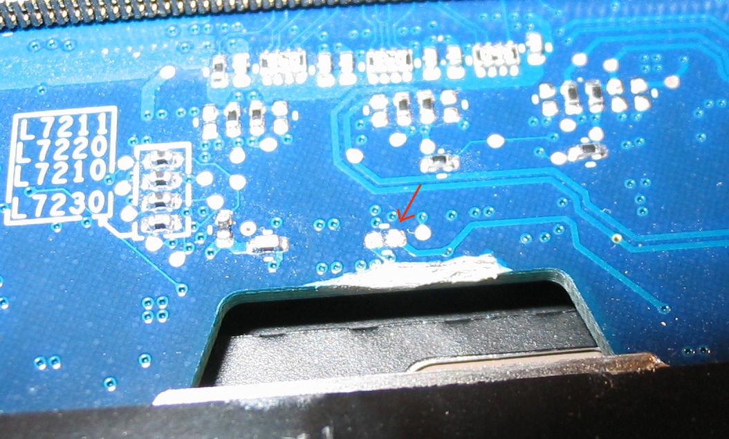

I decided to replace the thermal compound on my macbook since the warranty has ended recently. When I went to go take the ram out the first stick came out fine, the second one did not. I met the same resistance on the leaver as the first one but it suddenly gave and went all the way back without the stick being pushed out. After I opened it and managed to get the ram out I noticed that the part of the logic board that the leaver pushes against was damaged and a transistor? was broken clear off.
So I replaced the thermal compound and put it back together anyways, and well It seems to be working fine. But I was just wondering if anyone knows what I broke off was for and If I might have problems in the future because of it.
It's just above the red arrow.

Yes it does. I plan on doing a hardware test after the backup that I'm doing now.
Nothing seems to be wrong so far.....

If something like a transistor broke off, I'd be careful about using it without getting that bit replaced.
Usually there is a diagram on the logic board showing you what bit was there before (serial number, resistance value or something). I'd try and replace it.
You don't know what it's use was - could even have been a capacitor; without that you might end up with too much current sulking through something else at a given time and boom.
Every wee bit has a use - I'd try and find out what it was.

The fact that I was replacing the thermal compound is besides the point, this would have happened if I had just replaced the ram.

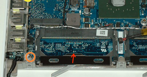

Well i decided to get better pictures of it in case it becomes a problem in the future. It's not labeled or anything and I can't see where it goes so I can't imagine figuring out what it does.
I had it on last night before this picture was taken and there are no burn marks or anything. I hope I'm extremely lucky because I can't afford a new mac yet.
