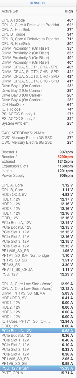

Hi,
At idle, Core A temp is at about 71° C Core B at 81° C
and fan B is really humming.
Now if I launch Geekbench 3, the temps "appear" to fall back to normal,
fans speed comes down as long as the cpu's are loaded 😡
using istats.

Sounds like you're quoting the "Core 0 Relative to ProcHot" sensor in iStat and not the "CPU A/B Tdiode" temp or "CPU A/B Heatsink" temp. Post those and we'll see - the "Relative to ProcHot" works backwards - it shows the degrees *until* it reaches its thermal limit so the higher it is the cooler the CPU is running. (which is why in your case when you load up Geekbench and start stressing it, it actually goes down)
We've actually discussed this here and there in a bunch of different threads on here lately - iStat shows that sensor correctly, but *incorrectly* starts marking it red when it goes up too far rather than when it goes down too far.
I've got the same 2 X5690's in mine (2009 upgraded to 5,1 firmware) and my temps at idle are:
CPU A Tdiode: 41c
CPU A Core 0 Relative to ProcHot: 61c
CPU A Heatsink: 40c
CPU B Tdiode: 35c
CPU B Core 0 Relative to ProcHot: 68c
CPU B Heatsink: 33c
Granted, I've modified my fan controls so that intake/exhaust run at a min. of 850rpm all the time rather than the default 600rpm on a 2009.

Hi Matt,
Man this thing had me scared, here's the istat (My first upload, hope it works)
Hi Matt,
The temps look fine, although there's a rather larger-than-normal diff between CPU A and B here. (CPU A is pretty much always a big hotter than CPU B - purely due to where it is located on the tray) That seems to be because of the high speed of your booster 2 fan though. I'm assuming you haven't used any fan control software and set that high speed on purpose right?
You'll probably want to do an SMC reset and see if you can power it up without that booster 2 fan going like crazy - it shouldn't be doing that.
Actually I was using Macs Fan control, trying to cool things down which from your explanation only made things worse because the differential in temps kept creeping up in red....
Great swap though, I went from 15K to 31K on the geekbench 3.
Thanks for your help! That Istat thing had me going crazy.
