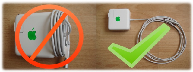

4r Power Plug Longevity suggest stowage this way:
