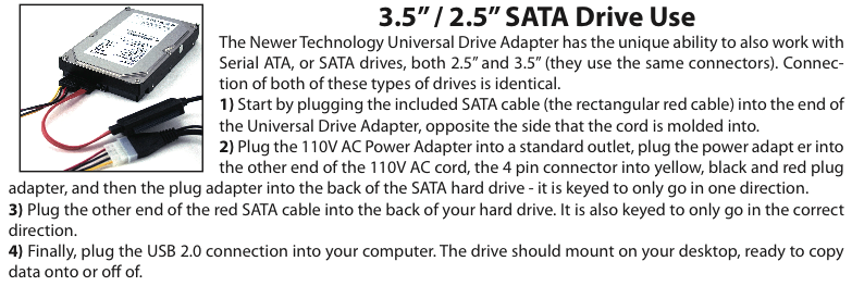

I bought the "newertechnology Universal Drive Adapter" and I connected a hdd to it, and the power supply to the hdd, and do the little hdd adapter that comes with the newertech universal hdd kit. But RIGHT when I connected the usb cable to my computer, it made some kind of sound like... something might have gotten fried, and at the same time the computer shut down, and the fans were spinning at full speed, making dust fly all over the place. So I disconnected the usb cable, and the computer stated up again about 5 seconds later, but the fans were still going at full speed. It started up... fineish. My bluetooth keyboard and mouse wouldn't connect, and normally they connect pretty quick, I restarted the computer and the same thing, they wouldn't connect, and the fan has been hauling ass this whole time. I shut down the computer, and let it sit for about 2 min, turned it back on.. and everything started working right, and the fans were quiet again, does somebody know if I fried something in my computer? Is there a way I can check? Everything seems to be working normal now... but that noise it made when I connected the usb cable still worries me... Thanks.

I quite don't understand the way you connected the drive to the newertech adapter... I have one of those, and the connection is pretty straightforward: the IDE/Sata data cable and power to the drive, the adapter's power to the wall, and the USB to the computer. Does the drive you were attempting to connect still work? were you using the adapter's original cables? perhaps it was the adapter which got fried...

I connected the SATA cable to the adapter and to the hdd, the power cable to the little power cable adapter, and from the power cable adapter to the hdd aswell. But from that power cable adapter there is a little power cable sticking out of it that connects to the newertech adapter, I connected that aswell... after what happened I refered back to the book that came with it and noticed that, that little power cable shouldn't be connected to the hdd adapter when connecting to a SATA hdd... Does that make sense?

that's it - that's the problem... it totally makes sense since you're connecting it wrong. See the attached instructions.
