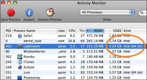

But you can use your 64-bit applications even if you booted into the 32-bit kernel.
I do that right now. Have a look at Activity Monitor and see for yourself.
You're confusing booting into the 64bit kernel and running 64bit apps.
By default SL will boot up the 32bit kernel but even with the 32bit kernel the OS is still capable of running 64bit programs.
