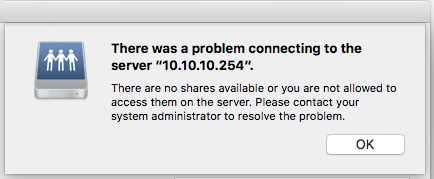

Ok. I got the RavPower drive and in setting it up on her computer I get this error... what is the problem? I can't seem to mount the RavPower in her shared devices. The drive is connected to the internet. Also, does she need the IOS app to use this or the Mac App as well? She has Filebrowser and would like to use that instead.
Thanks for the help!
Not clear to me but it sounds like you are trying set the FileHub up as a share point on a Mac? The FileHub without attached storage is really just a router and I think to be a share on the Mac, it has to have storage (the storage being the share). I'm a Windows person so I'm coming from that perspective but did that make sense?

Hi. I am trying to do this...
https://www.ravpower.com/media/downloads/How to connect filehub plus with mac.pdf
After I enter the admin name and password that’s when I get the error message. The drive won’t mount so I can’t see the contents on my SD card. According to these instructions it should show up under my shared devices in the Finder allowing me to view the contents. It does not.
I am not a network guru so any help in setting this up on her Mac is appreciated.

Searching on the error message, I couldn't find anything that was helpful in debugging it and not being a Mac person, I don't have much insight there. I'd recommend bundling all the info you have into an email message to RAVPower Support (support@ravpower.com). I'll play some more with my device and see if I can find anything useful on the net.

Have you tried typing the smb web address into safari? I have to do this to connect to other smb drives on my mac.
Hey guys... I figured this one out. I didn't have the SD card pushed all the way in to the RavPower. I thought it was in but is wasn't. Once it was in, it worked.

Glad it worked out. And so it was the equivalent of not having storage plugged in - interesting.
