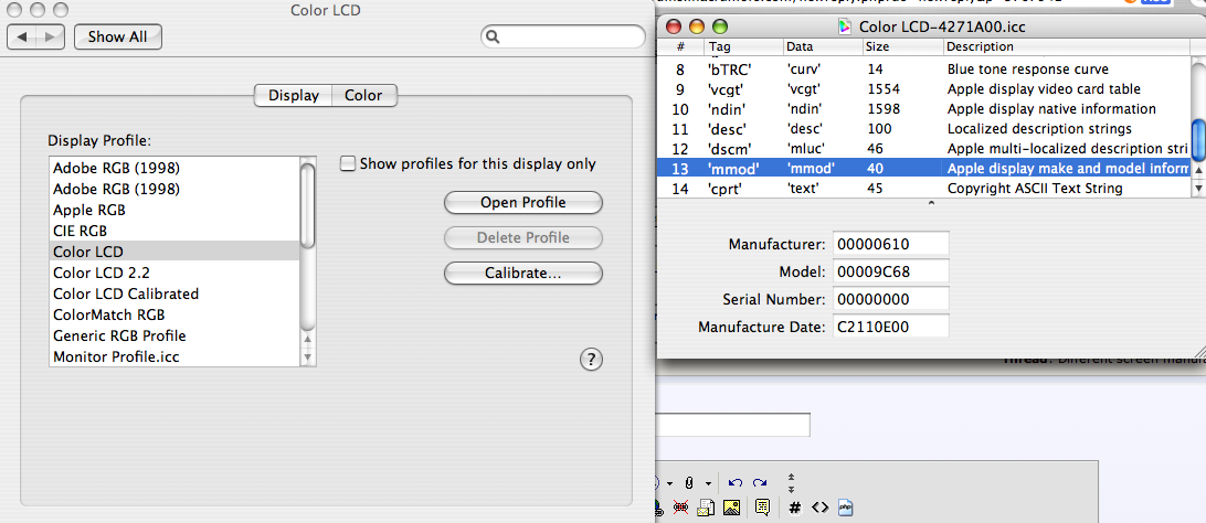

You can check the model by going to System Preference -> Display -> Color, select Color LCD and click "Open Profile". In this window, you will see the model info under "13 mmod".
