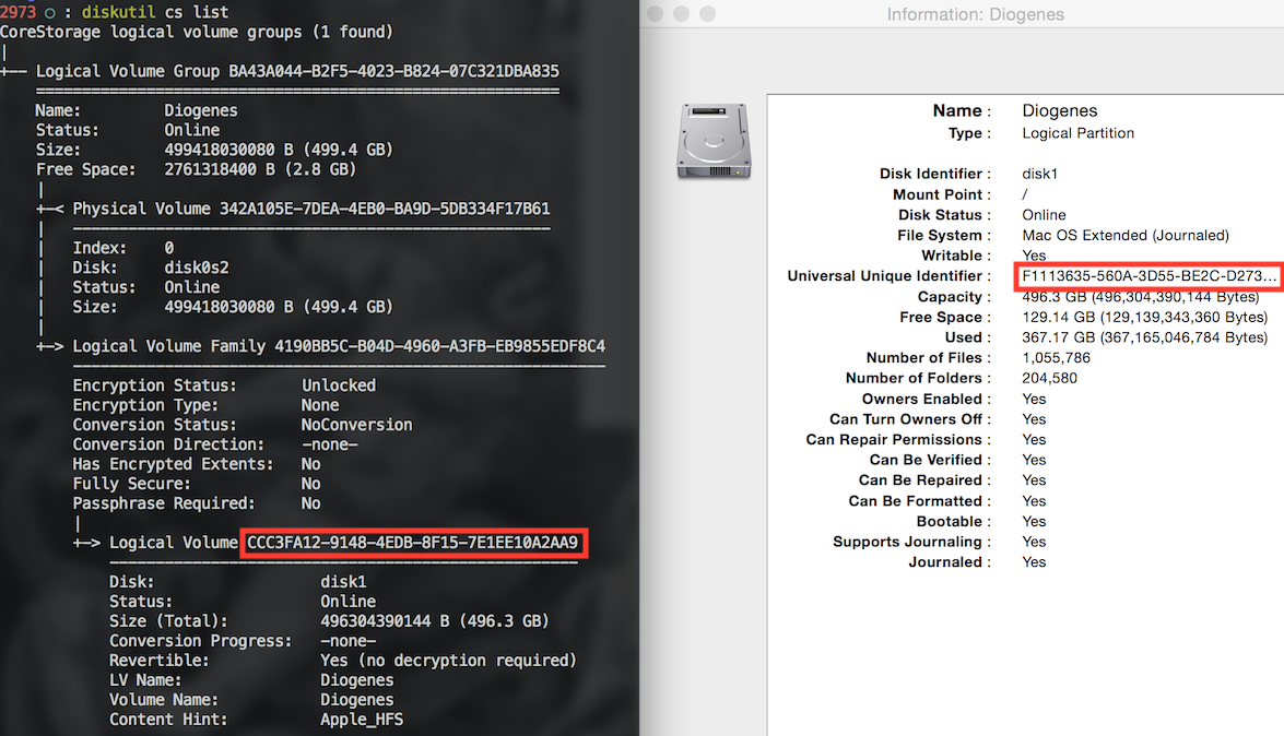

Hi, Yosemite seems to convert boot partitions into CoreStorage volumes, and my main root volume has 2 different UUIDs when I check via diskutil or "Get Info" in Disk Utility:
attachment.php
I thought the idea of the UUID was that it was Universally Unique? Perhaps this is an issue with Disk Utility?
Do other users see two different UUIDs for their main boot volume?
Also my Recovery HD is not accessible when I use [option] on a reboot (though of course ⌘R works), is that normal for Yosemite (perhaps this has been hidden for a while)?

What you are seeing is normal and you are not seeing what you think.
That info screen from Disk Util is the hardware UUID for your drive and is hard coded into the drive itself. It will never change.
Those UUIDs you are seeing in Terminal are all made up by the OS when creating the core storage volume.
Go to Apple menu then About this Mac then System Report and scroll down to the Storage section on the left and click it. In there you will see the volume UUID for the hard drive (disk1 hardware UUID) that will match the one in Disk Util. Below that you will see the UUIDs for the logical volumes the OS assigned.
Yeah... that seems to be new with Yosemite and I have seen others report the same thing.
