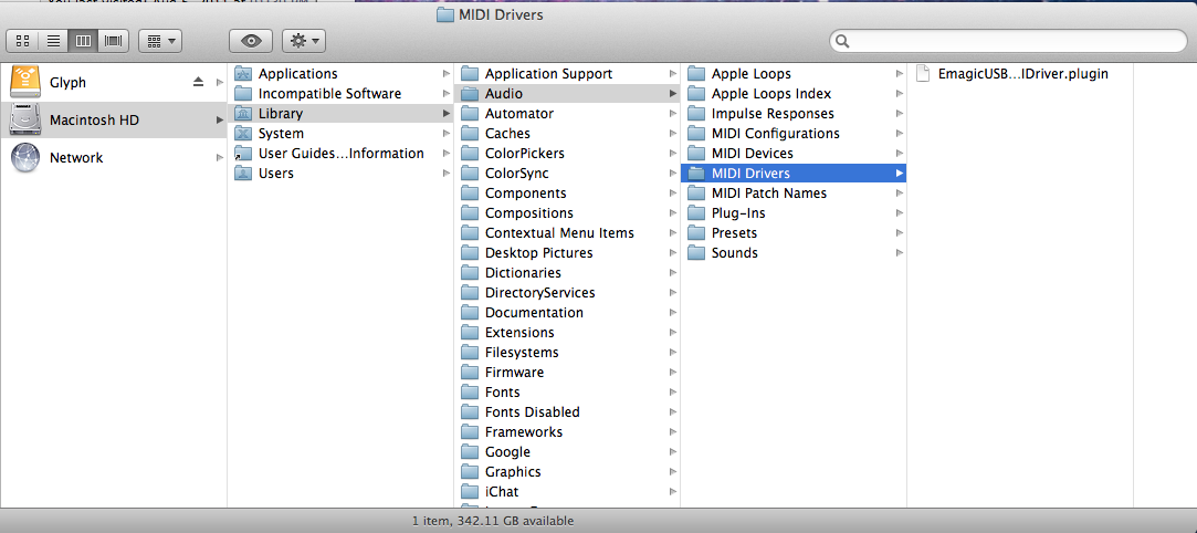

After following your instruction and installing the coreaudio driver and PACE file, audio midi setup on my new Lion Macbook pro sees my digi 002 Rack as audio but is unable to load the midi studio, producing an eror report about midi driver. Has anyone worked with a digi 002 rack as a midi interface on OSX Lion? Any drivers I need for that?
Thanks
delete old MIDI drivers
Thanks
Open the Macintosh HD and then go into the Library. In the Library is a folder named Audio, and in the Audio folder is another folder named Midi Drivers. Delete all the MIDI drivers from that folder. I think the Emagic one is supposed to be there, but it doesn't hurt if you delete it. I had the same problem; it was old Digidesign drivers that caused it. Deleting the MIDI drivers should fix it. Here's the path: /Macintosh HD/Library/Audio/Midi Drivers/

deleting MIDI drivers didn't work
Thanks kinich_ahua, but still no luck here.
I installed the stanalone driver v803 but still have no MIDI showing up in the AudioMIDI setup
