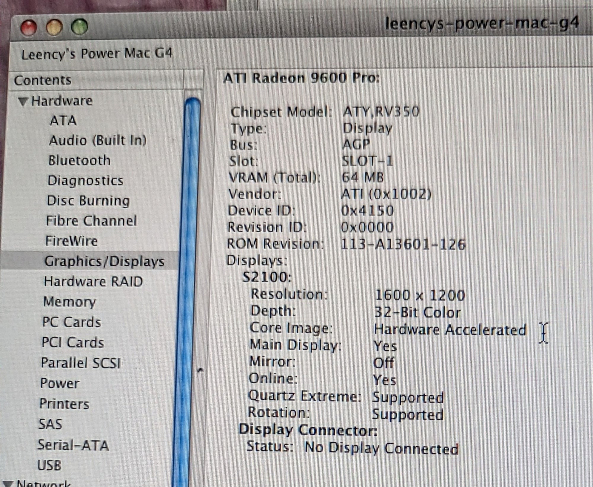

When I put 9600 Pro (G5) into G4 MDD > it works via DVI. But PSU coolers are always running at full speed, how to fix that?
(Is that caused by non-attached ADC connector?)
