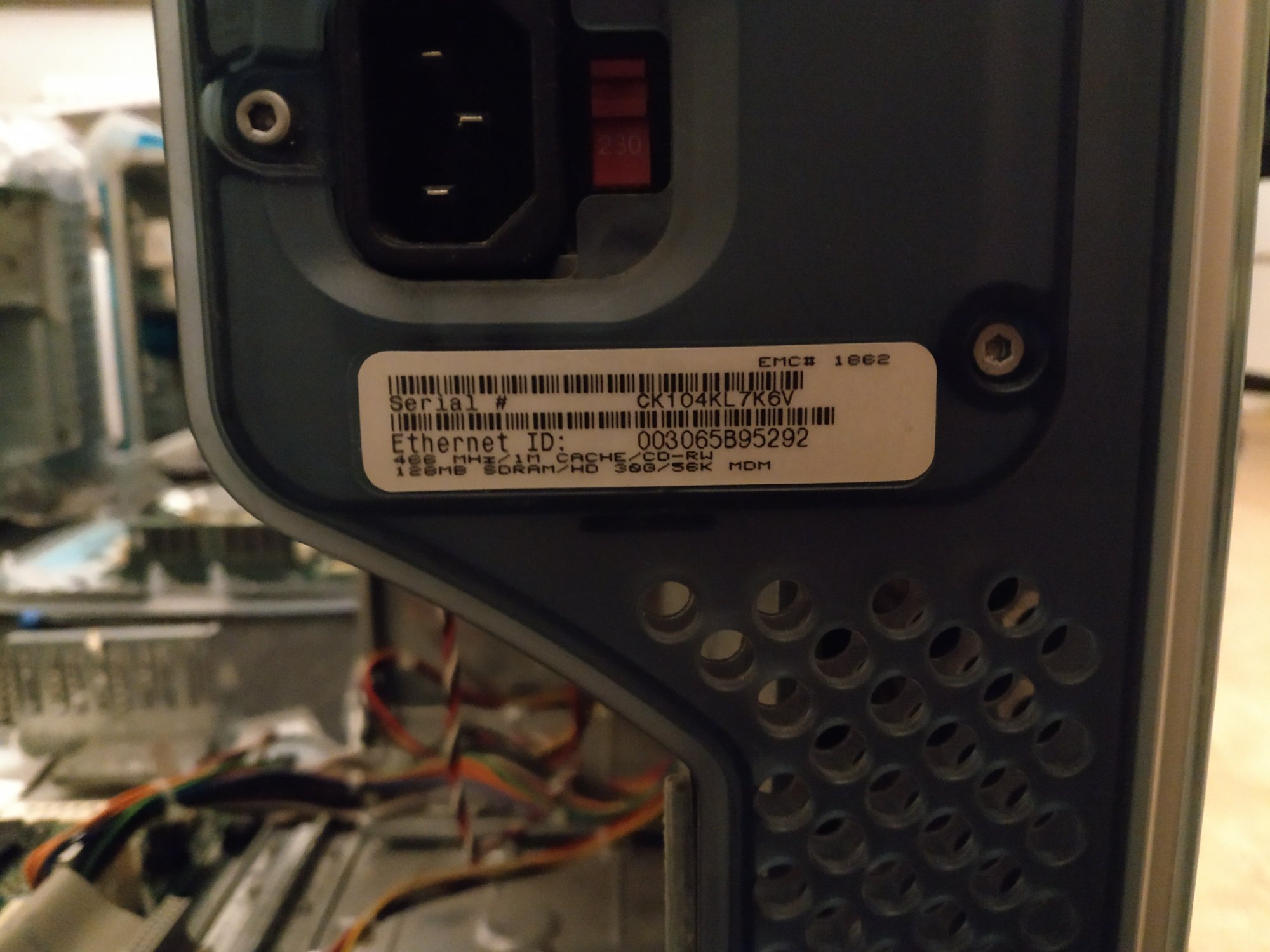

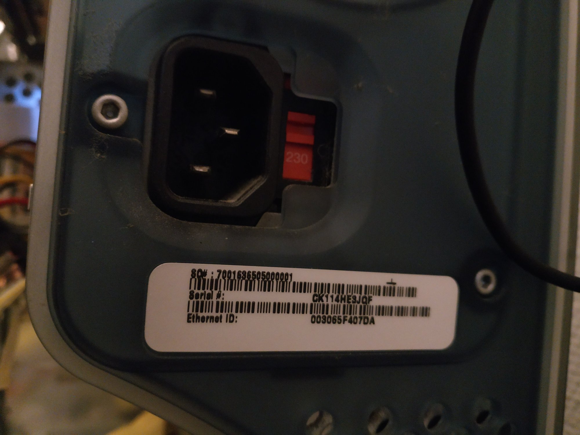

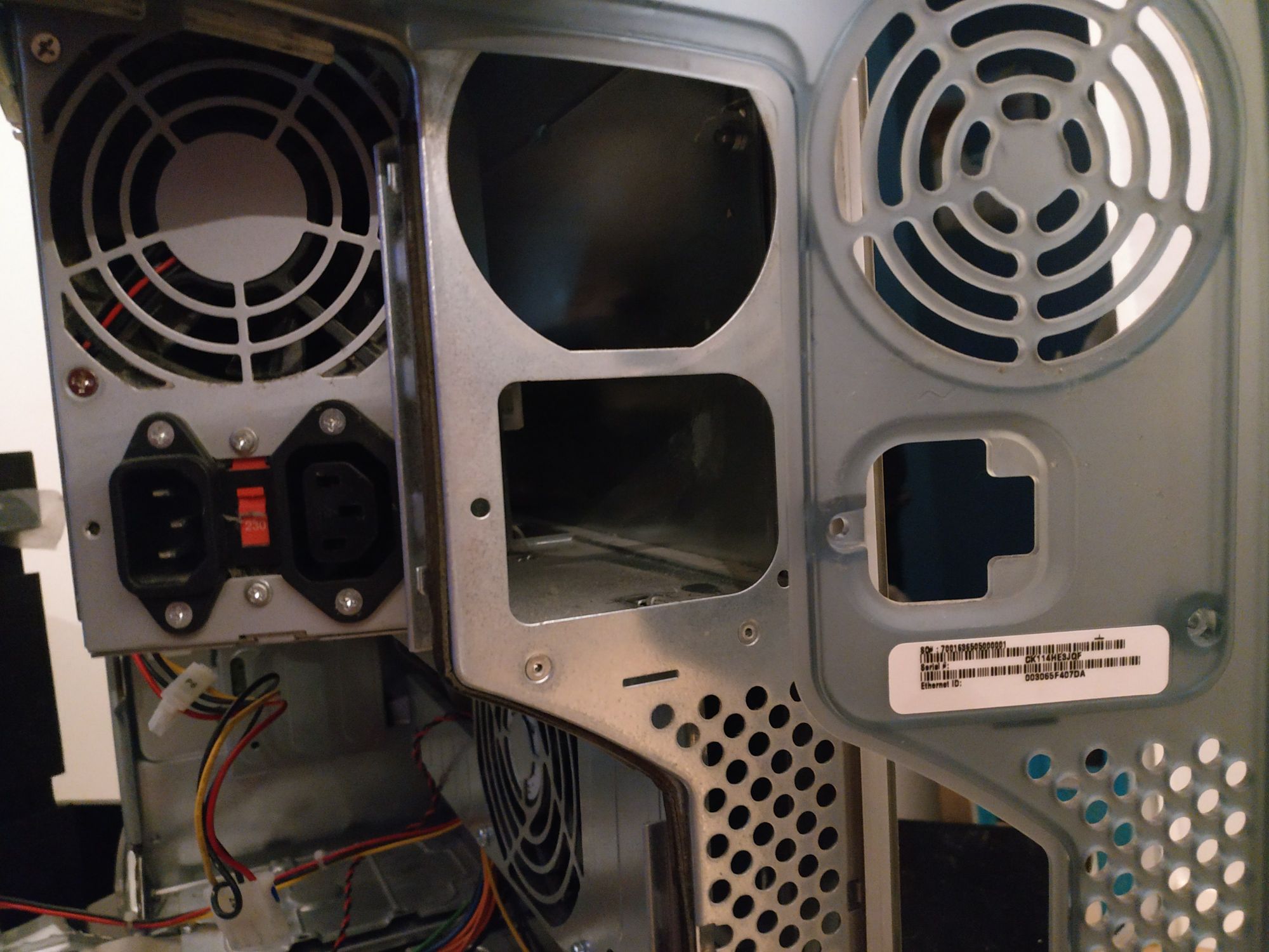

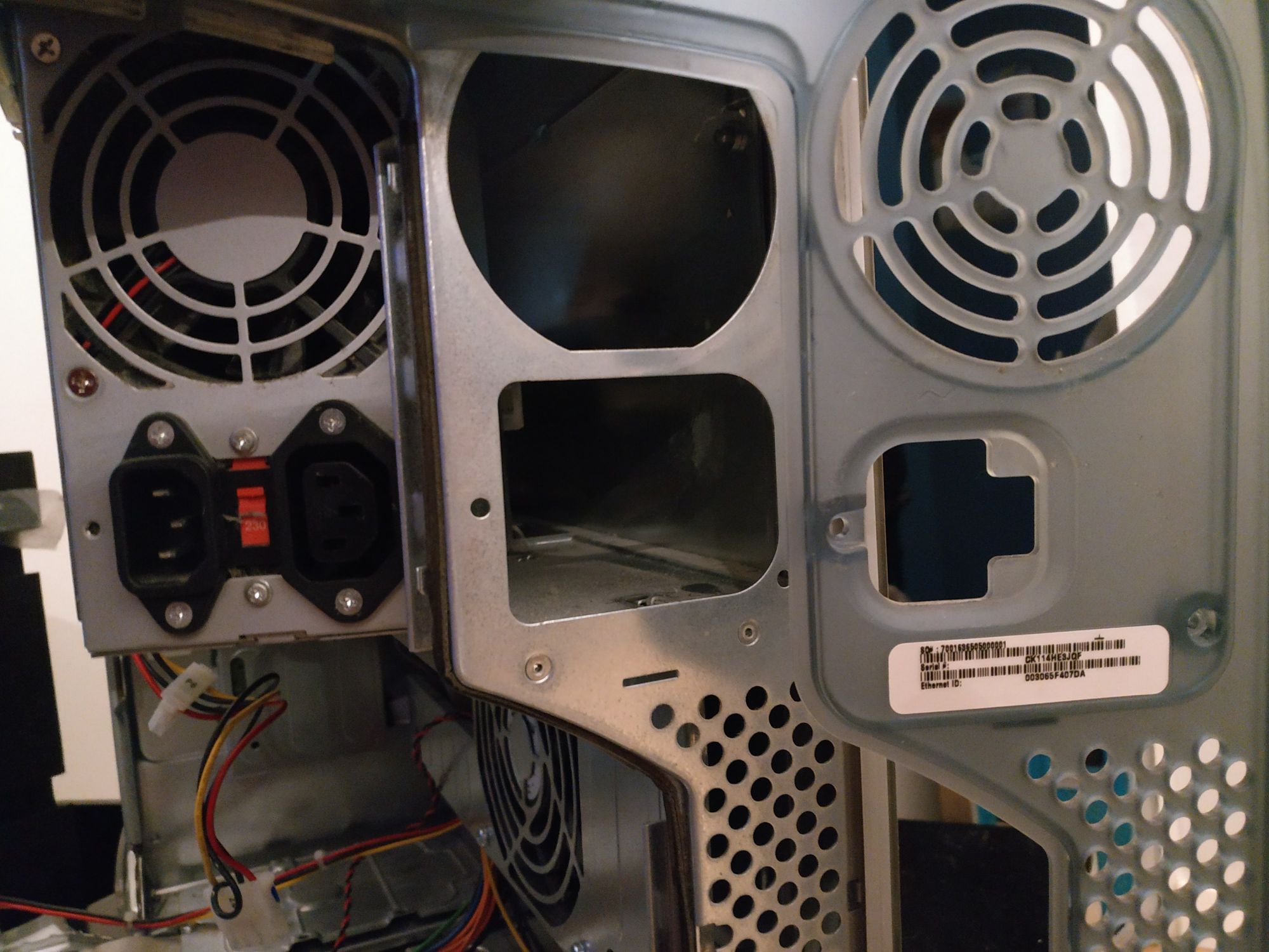

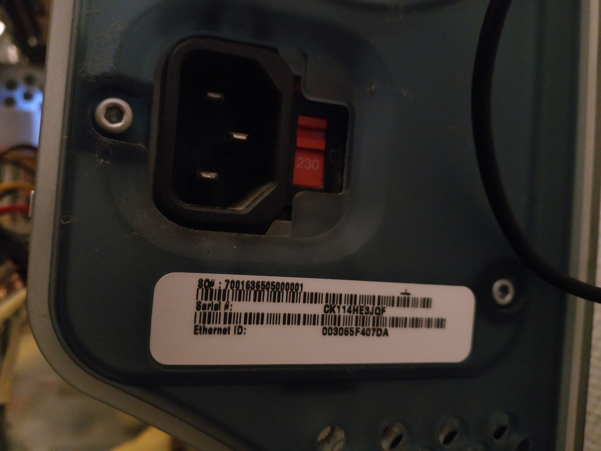

A while ago I picked up a collection of PowerMacs to further repair and upgrade my main Powermac. The collection included two MDDs, two DAs, and one B&W. As I disassembled the two DA's, I noticed there was something odd - you see, for my main powermac I prefer to have a PSU pass-through (so you can chain the monitor without occupying another slot on your power strip), however, by looking at pictures online, I was led to believe the DA and beyond had reverted back to input-only PSU designs on the back. Or so I thought, because I found out that one of the DA PSU's actually had a pass-through, with the metal cage accomodating for it, but not the casing itself. Strange. Furthermore, the output-port was blocked by a sticker.

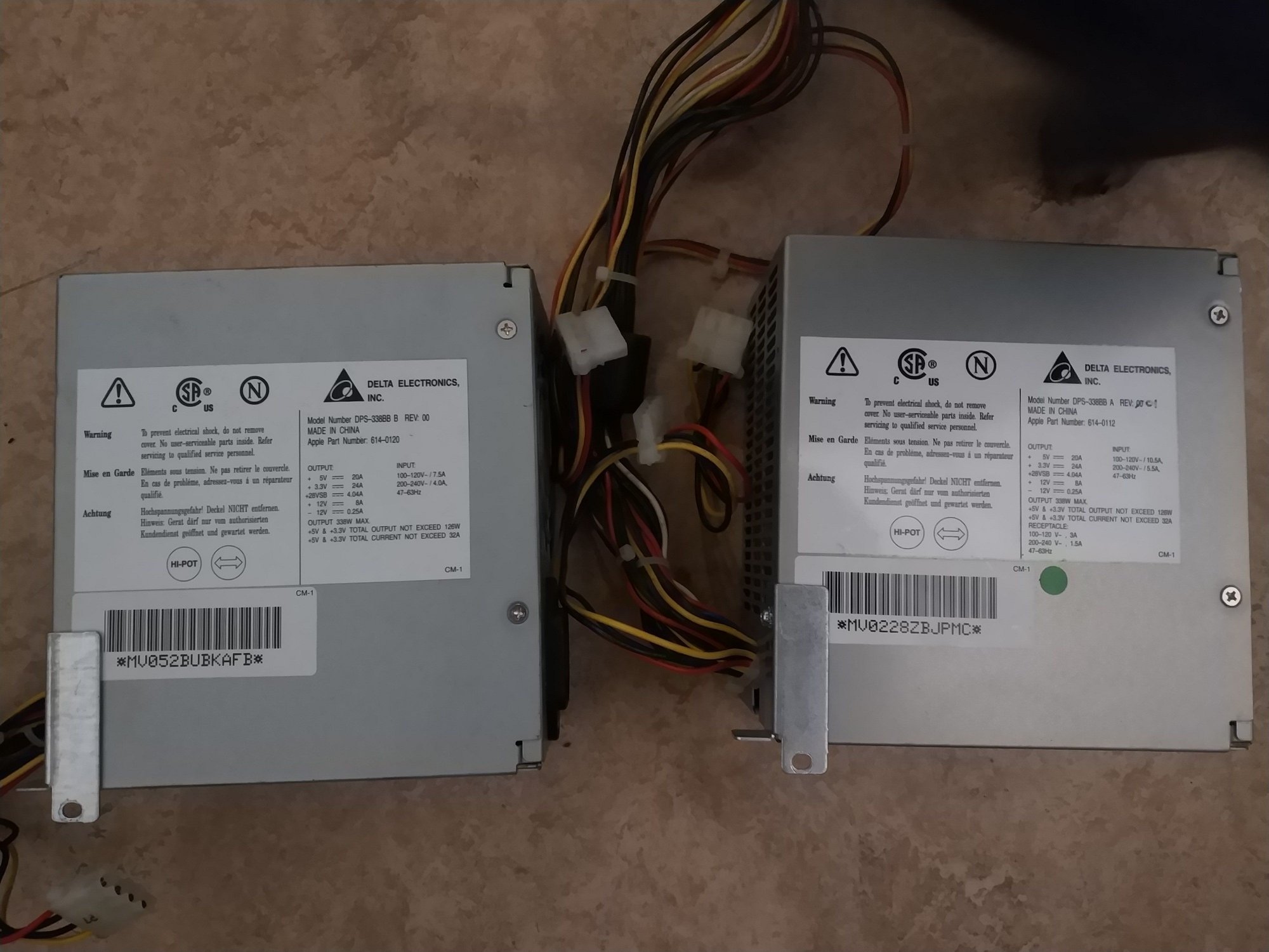

I checked both of the PSU's of the DA models and both model numbers are identical (so it wouldn't have been a transplant from a Sawtooth, I think?), however the revision number on the pass-through one has a handwritten "01" on it. As far as I could tell, the PSU's didn't seem internally modified, and they worked just fine. The Apple part number differs, though, and the serial number on the pass-through DA itself was manufactured later than the other one. So my conclusion is that this might have been a custom option when ordering? I'm really not sure. Any ideas?

The PSUs were slightly moddified ATX PSUs that Apple bought in bulk and this came with a batch that shipped with thar outlet. My guess is that Apple had over ordered for the old style case and your PMAC was an early one wit no passthrough option.
No BTO for this.
