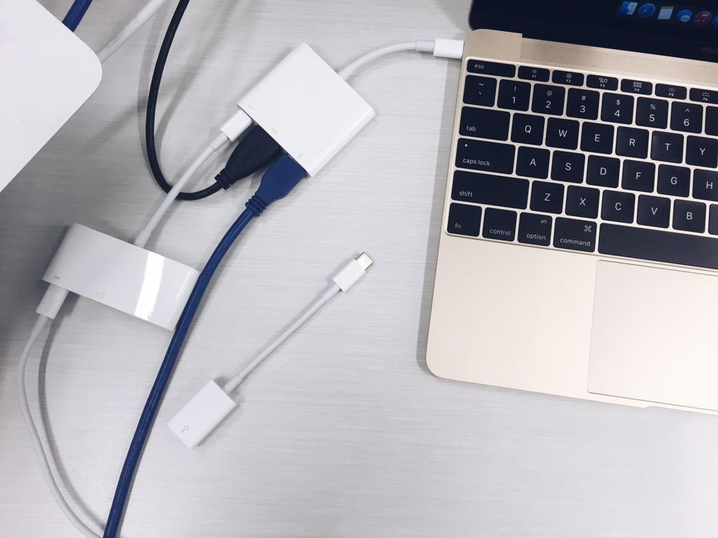

You plugged the hub into the charger and the supplied USB-C cable from there to the computer. I assume it still charges, but you're saying it now doesn't work as a USB or HDMI port on the computer?
I wonder what is causing that? Is it a limitation of the adaptor, or of USB-C, or does the USB-C cable supplied by Apple only do charging and not data. I wonder whether a different 2 metre USB-C cable would allow that to work?
It seems to me to be the entire point of the one-port design -- then there is only one cable to the laptop and not the mess of bits and cable ends shown in the original picture.

thank god you put a piece of paper between the rMB and the desk...
makes you wonder why apple didn't engineer black round (replaceable) feet onto the bottom of their notebooks.....
