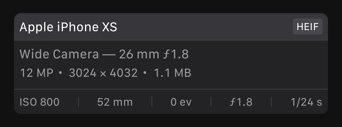

Here is an example from my old XS (has a 1x and 2x lens). I had the 2x zoom selected, which corresponds to the telephoto lens, but it took the picture using the 1x lens (it says "Wide Camera" instead of "Telephoto Camera") and digitally zoomed in two times (focal length of the lens is 26mm, but the picture was taken using 52mm).
Here's what it looks like when it did the 2x zoom optically. It used the Telephoto Camera (2x lens), and the two focal length numbers are the same (no digital zoom).
