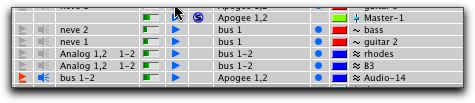

i assigned a few recorded tracks to bus 1/2, set bus 1/2 as the input source for a stereo audio track and hit record...worked fine. check to see that the master track is play enabled even though you're not using it as a source for your recording.
is the audio showing up on the input meter of the recording track? it should be. i've attached a quick screenshot showing the routing.
