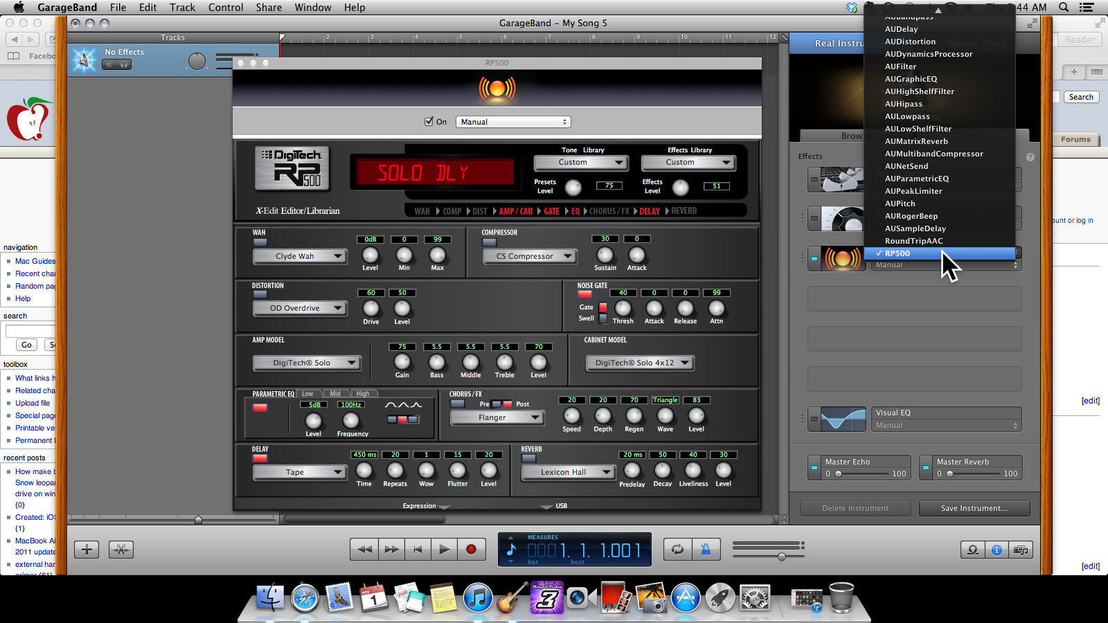

I HAVE A FIX for getting X-Edit to run on Mac OSX Mountain Lion 10.8.2 !!! Since Digitech is slow at getting there software together and updated for Mac OSX Mountain Lion, I figured i had to find a solution some how.. because everyone has been asking WHEN they would resolve the issue and all we keep getting is " We are working on the problem" ....Thats great to know! ANYWAYS! People listen up ( oh and Digitech, I am sure you can take note of this to so you can tell your customers to use this little trick until your software is ready"... Install the most recent version of X-Edit for your Mac and you know when you open X-Ecit you get the error and you have to close it.. Well here is a temp. fix. This allows you to do EVERYTHING via X-Edit but the ONLY down side to it, Is you have to manually hit SAVE to store the preset once your done building a patch or adjusting a patch. Open up Garageband ( if your on a Mac then you have Garageband ) and just take the steps as if you were going to record a track ( no need to enable record, just go to select real instrument ), Go over to the right panel ( where you add effects to the track ) and at the bottom of the list of all the effects and plugins that you can add to the track, you will see a plugin/effect with the name of your device ( in my case i am using a Digitech RP500 and a RP155 So it says RP500 or RP155 ). Select it, Once selected just click on the box as if you were going to edit the effect/plugin and BAM! X-Edit opens up perfectly.. It allows you to adjust anything ( even USB and EXP pedal settings ) the ONLY limitation like i said is when you want to store your preset or save it, You will need to manually click STORE on the actual unit itself. So far this has been working for me without a problem and i have been updating and making new patches all day without any issues. I sure hope this helps out the rest of the Mac community that is having these issues. Your pretty much opening X-Edit thru garageband rather then opening it by itself on the desktop. I attached a screenshot.

Thanks so much for this maf2k8, I've been running it through windows on my MBP for the last few months.
I have the RP500, and been frustrated with the same incompatibility problem with OS 10.8. Glad I found this thread! After much trouble with just Garageband alone, I finally managed to launch and get the X-Edit window you describe above.
I'm a total newbie right now, but I would like to load some presets (files saved on my computer) onto my RP500. But I do not see any way to do this from this X-Edit window in Garageband. There does not appear to be a File menu or anything about loading/opening presets to allow for saving to the RP500?
Any more guidance is greatly appreciated. Thanks!
