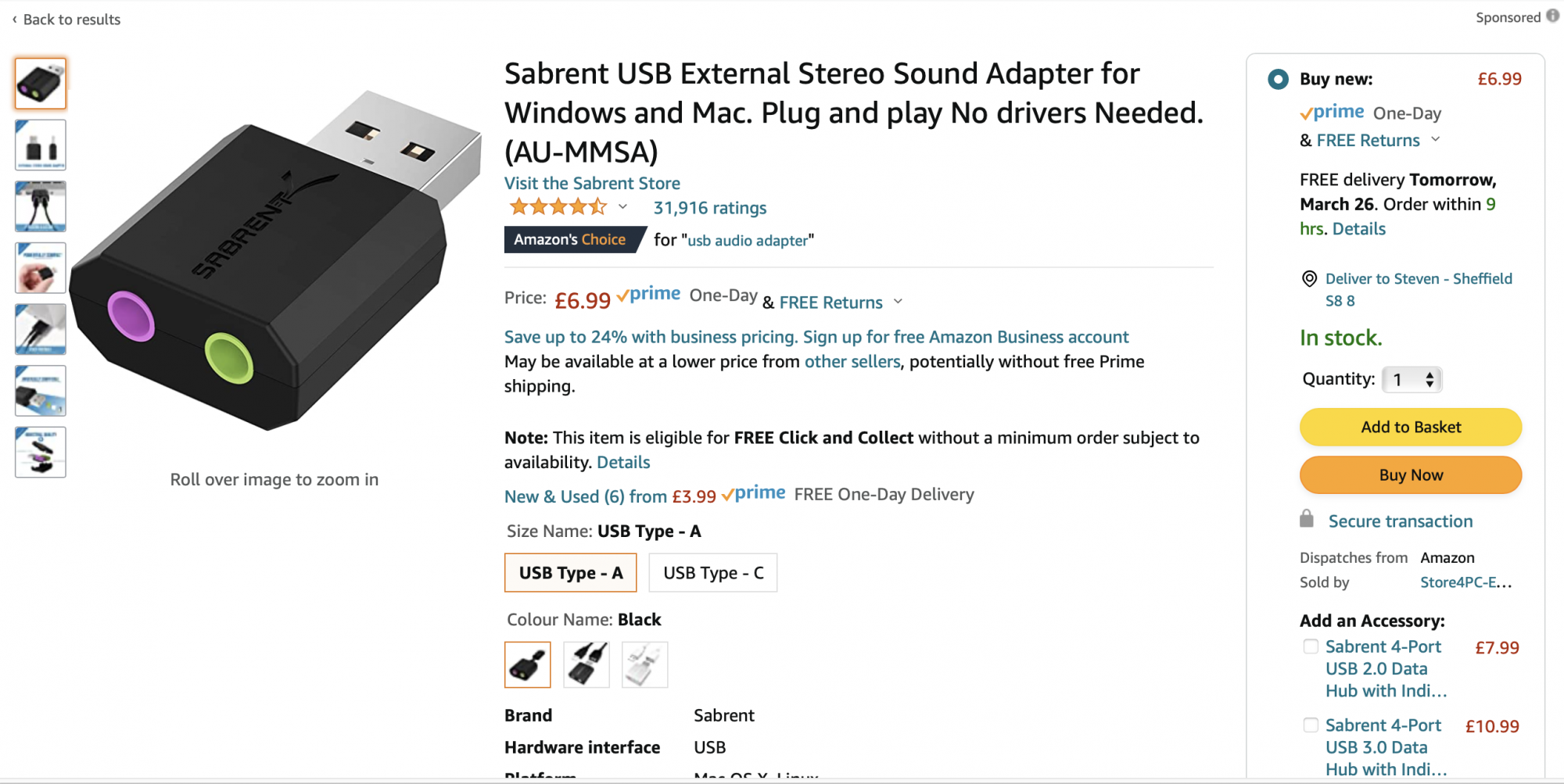

I'm guessing doing the following should work..
3.5mm mic cable plugged into the cassette players headphone port, and the other end plugged into a USB audio adapter such as the one below (UK), and then run an app such as Audacity?

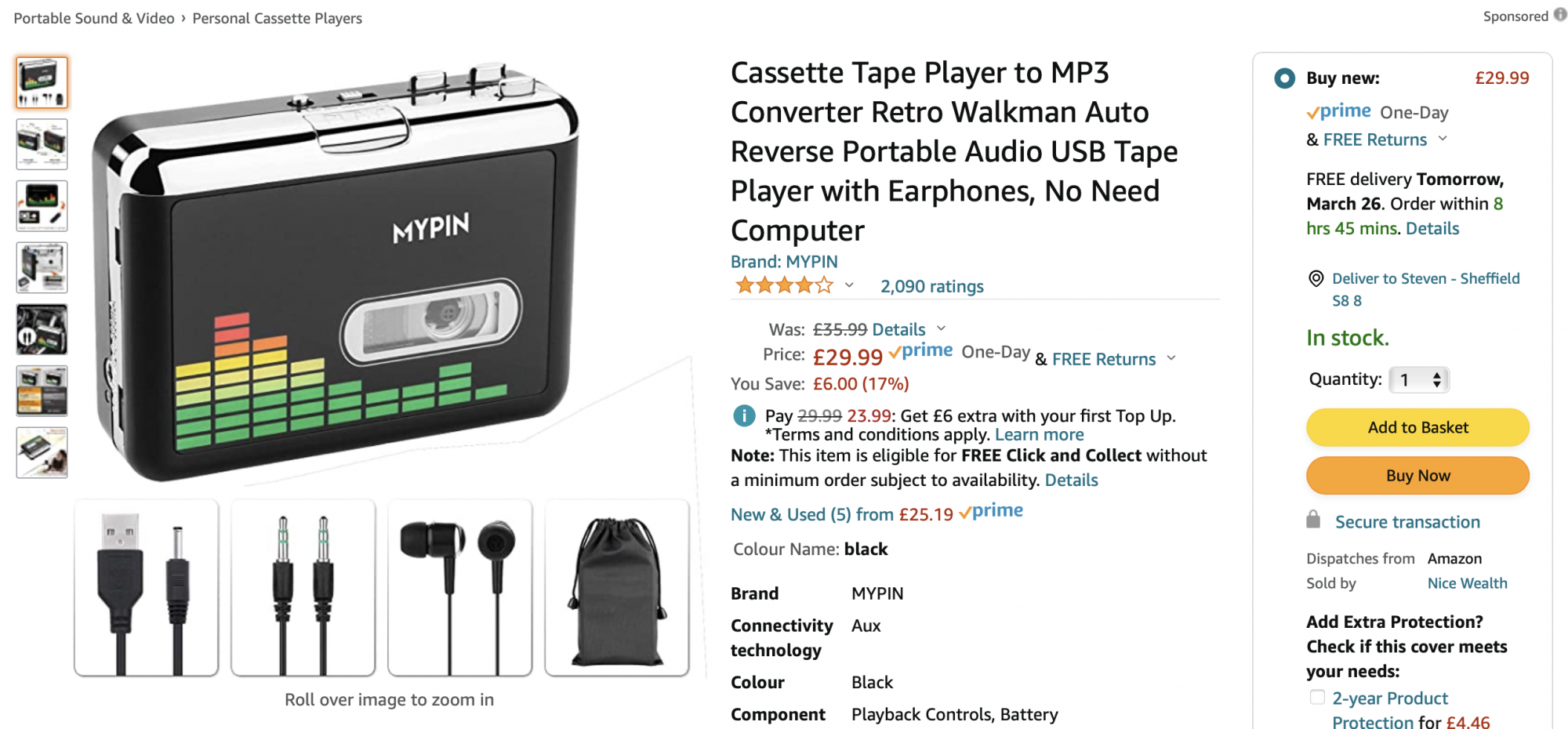

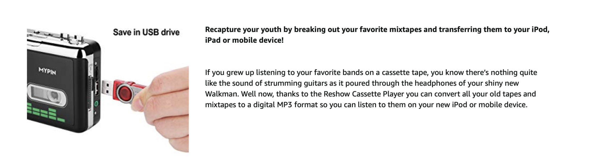

Or....some research suggests I could buy one of these cassette players that accepts a USB drive to record directly onto...

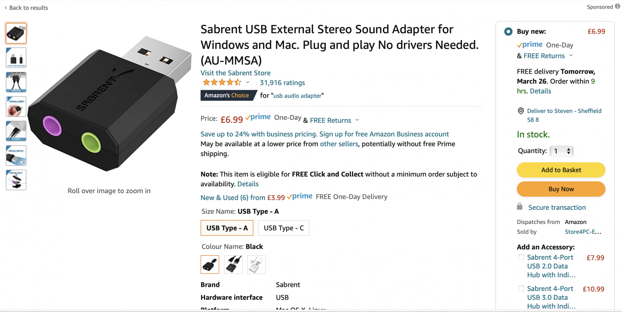

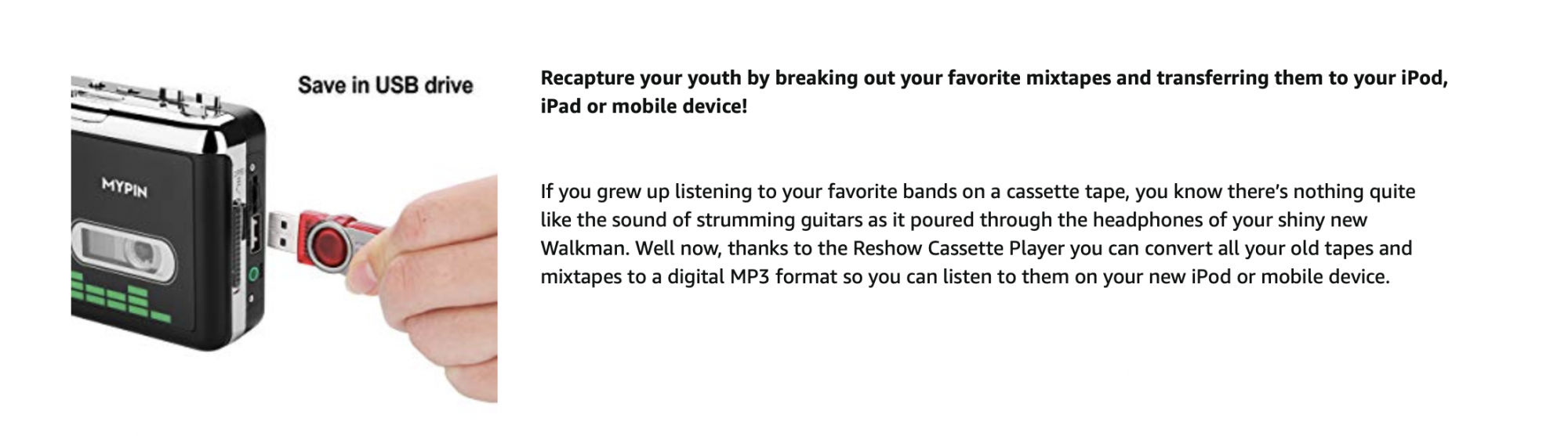

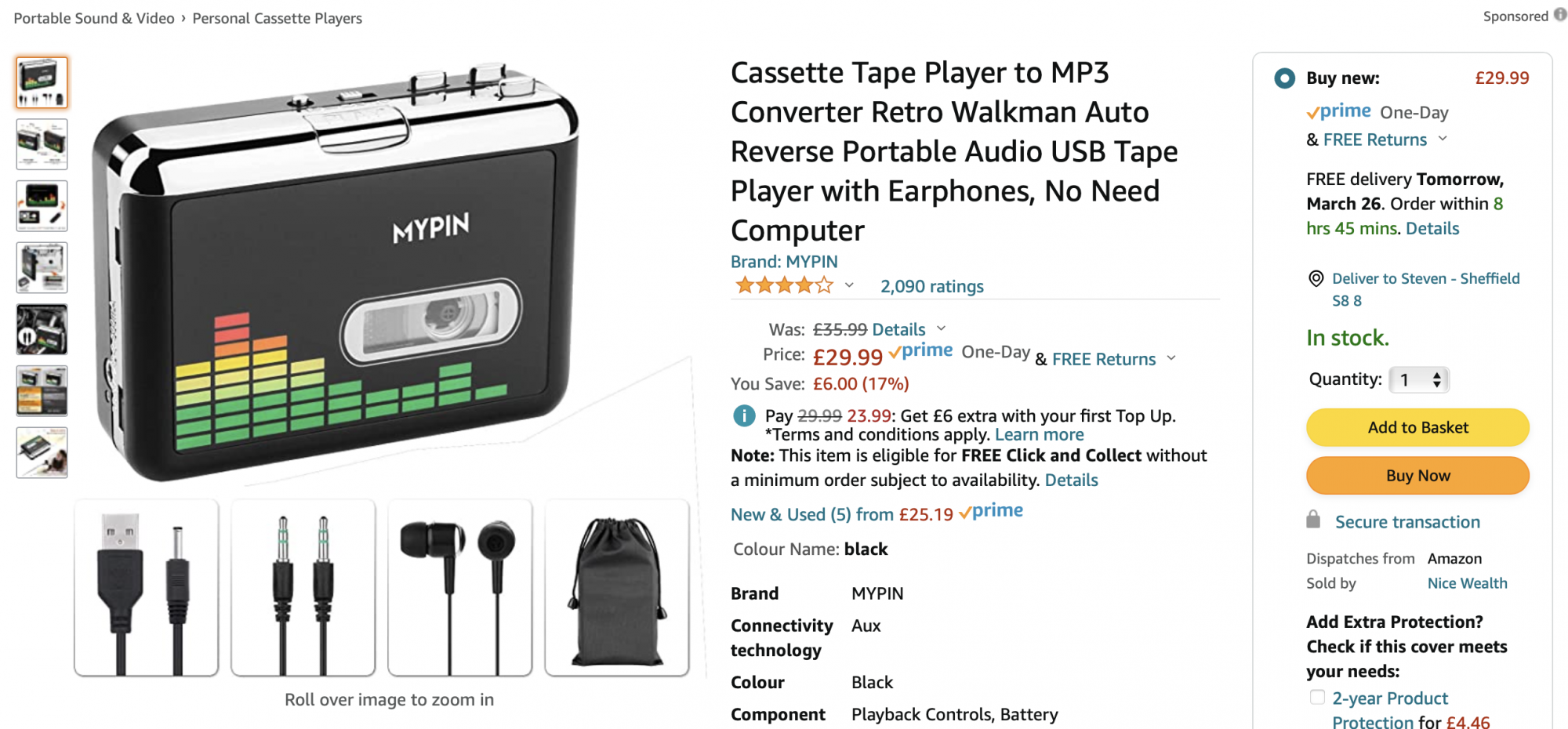

I can't comment on the MYPIN device, but the UGREEN interface is not likely what you want. It has only mono microphone input. It is stereo only for output.
Something like this Pyle mixer would provide AUX level stereo input: https://www.amazon.com/Pyle-2-Chann...8c440b&pd_rd_wg=4t6Mu&pd_rd_i=B003CY6OHY&th=1

If this is all you want to transfer, the Mypin might work. But if you're transferring A LOT of tapes and want better audio quality, you'll need:
