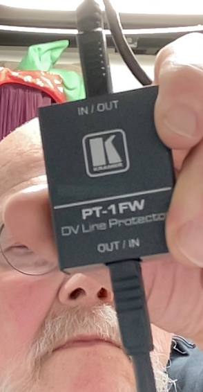

You may be on to something. As I recall when I used this on Snow Leopard I used a Kramer PT-1FW DV Line Protector. Is there someway I could incorporate this into the chain for the iMac?

I'm not familiar with that. See if you can borrow a TB dock, or find one cheap via eBay.
