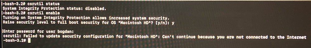

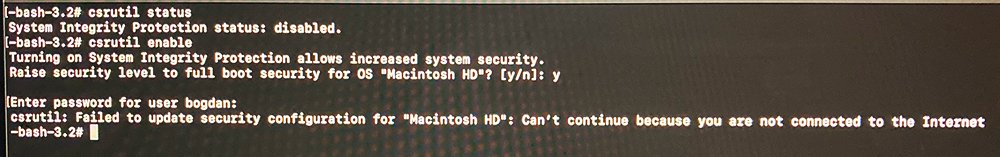

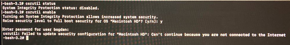

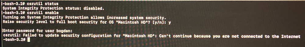

Apple's surveillance of users has reached new heights on Apple Silicon. You can not disable/enable SIP without being connected to the Internet.
I turn it off temporarily, do what I need to do, and then turn it back on. And it's rare that I need to. Once every couple of years maybe.
