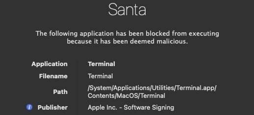

Santa can block Terminal.
As Santa is managed through Terminal with santactl, the only way to reenable Terminal is to delete Santa (requires admin password) and reboot.
https://github.com/google/santa
https://santa.dev/details/rules.html
