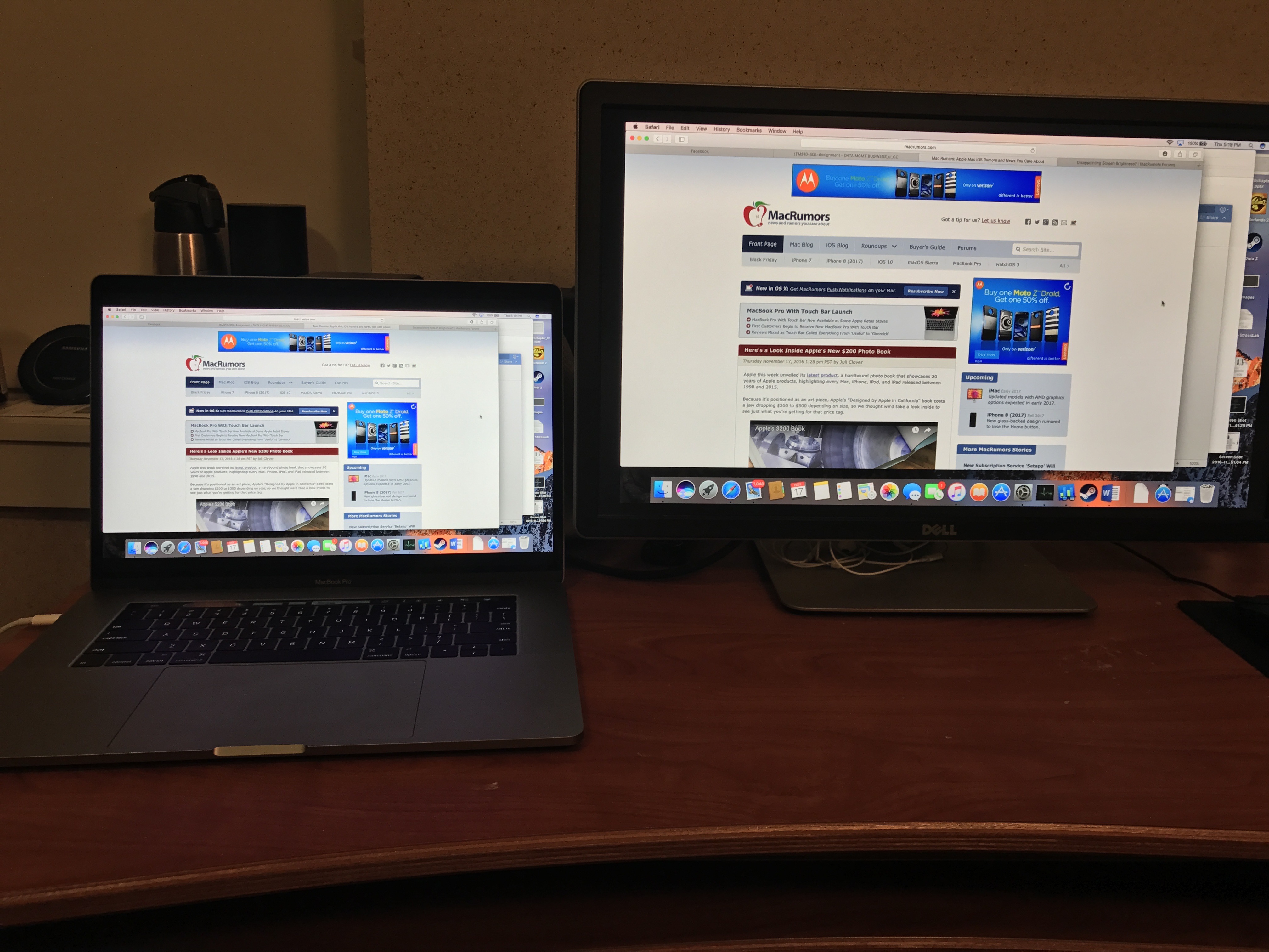

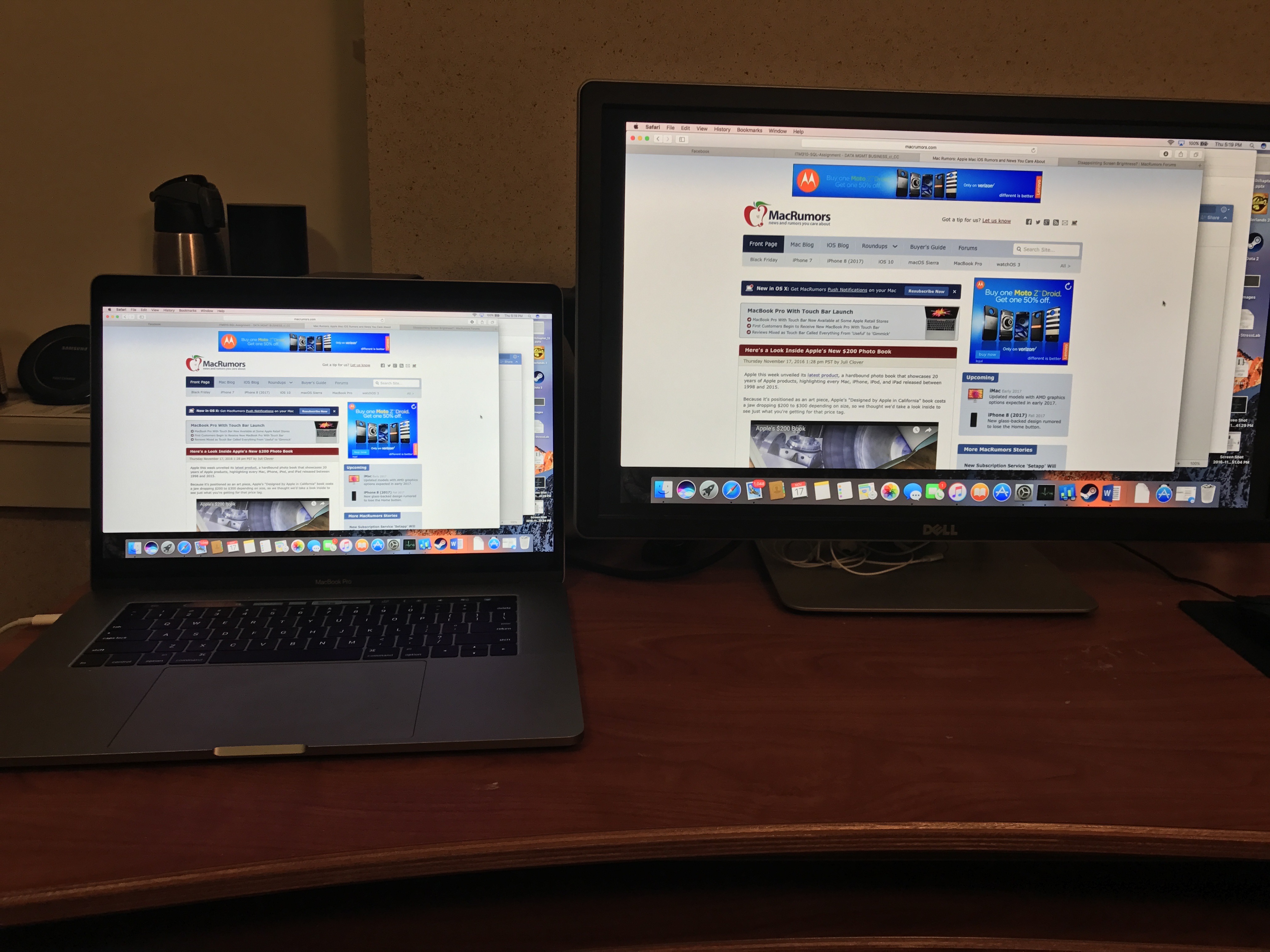

Okay so interestingly I compared my 300nit rated external monitor (Dell P2415Q) and my MacBook side by side and it is clear that the MacBook is brighter. 200 nits brighter? I don't think so, but it definitely is brighter. I'm still curious on these measurements.

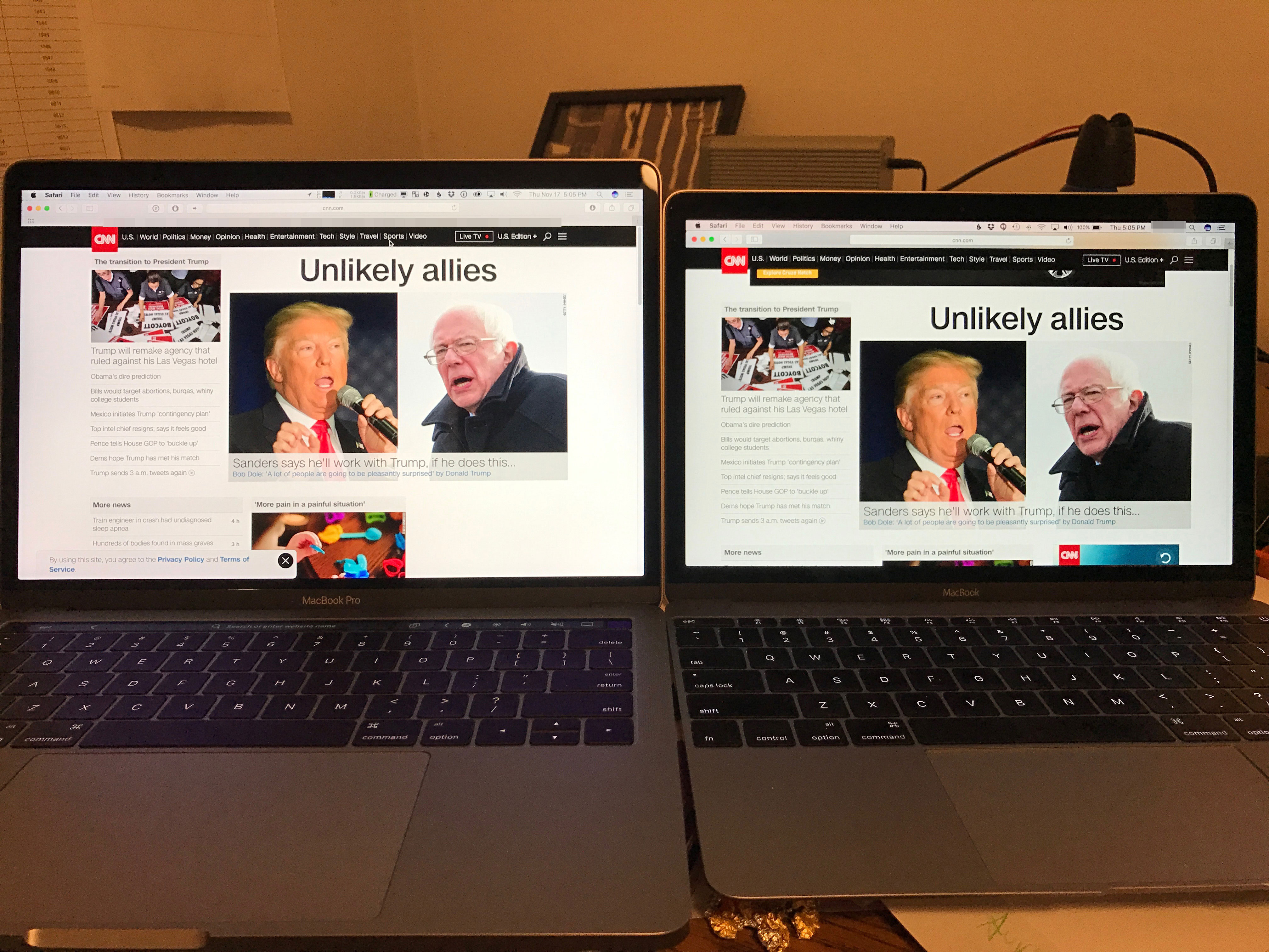

Here is my 13 next to the 12 it's replacing (the 12 is going to another employee in the company). Both are set at 3 clicks in from the max. Comparatively, it looks brighter, so maybe i'm imagining it? Sorry for the photo quality, taken with an iPhone 7 but bad office lighting.

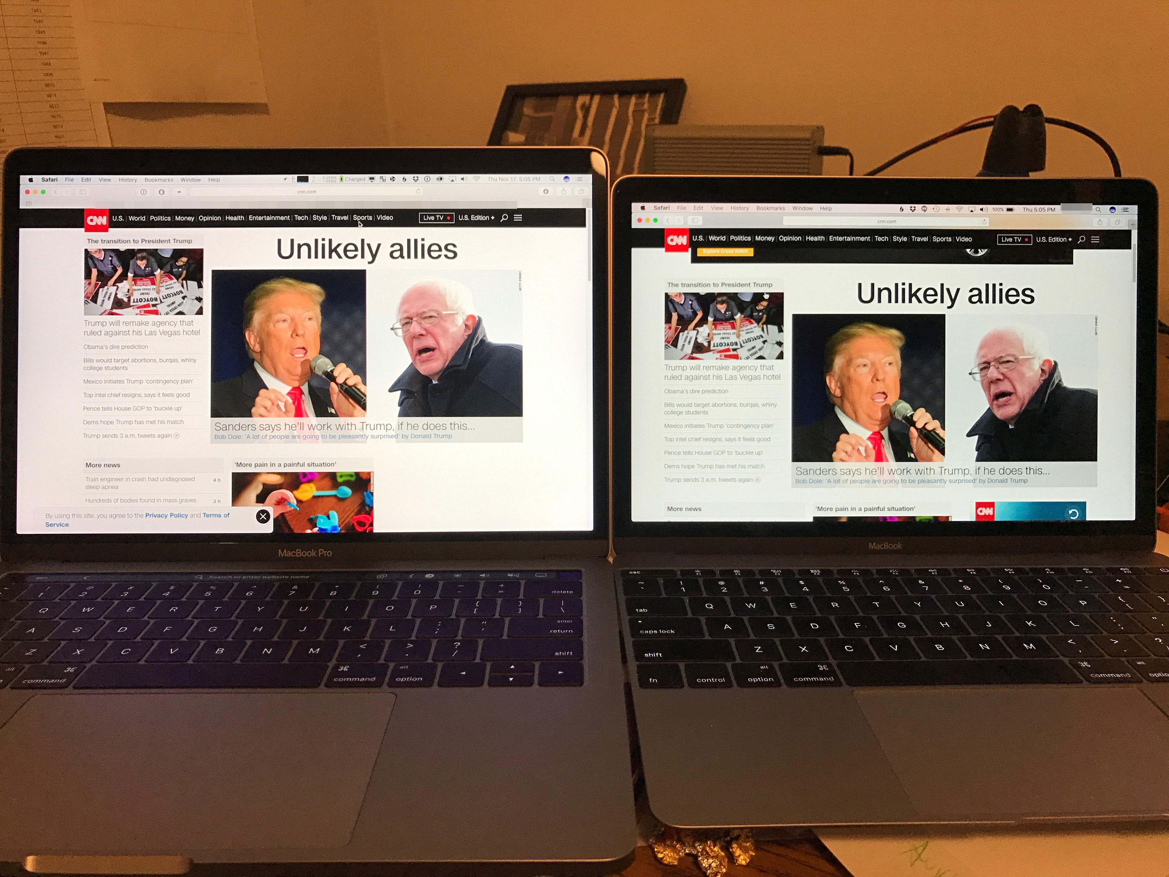

The problem is that "3 clicks from the max" isn't necessarily indicative of anything. While we might expect that setting to mean 70% of maximum possible brightness, that might not in fact be the case. Comparing both displays at maximum brightness would be more useful.
Starting with iPhone 7, full screen brightness can only be achieved through the auto brightness feature in light which warrants it (as reported by Anandtech).
Perhaps the new MacBook Pros have the same thing - max brightness on the manual adjustment may not be peak brightness (or "boost" brightness as Anandtech called it). Maybe take your MacBook out into the sun to see if it seems brighter?
