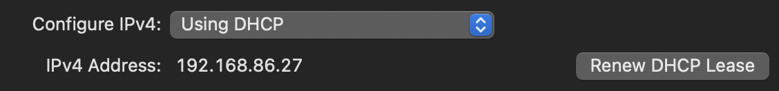

It means your router isn't assigning an IP via DHCP. It's configured that way on MacOS by default but you might want to check.
Otherwise, did you perhaps manually limit assignments via MAC addresses at one point?

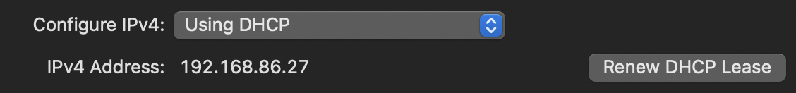

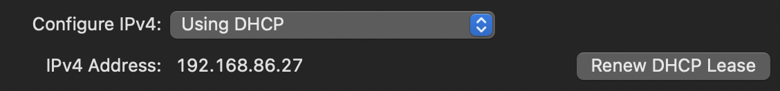

Just depends on the router, and how it and your modem are configured (like if the router is the one doing NAT or not) Can't say for sure.
Anyway is your interface in MacOS set to 'Using DHCP'? Have you tried clicking the renew button?
If it doesn't assign one try DHCP with manual IP. You can manually assign it any IP not in use in the range the router specified.
