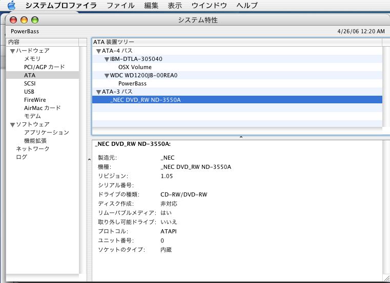

I just installed an NEC DVD-RW ND-3550A in OS 10.3.9 on my new PMG4 D.A., and the drive was not supported, blah blah blah. I was expecting that. What I wasn't expecting was after installing and running Patchburn 3.1.3, it changed all the text from System Profiler from English to Japanese, as shown in the attached picture.
I do plan on upgrading to Tiger, as soon as I get some time from my rather hectic schedule.
You may want to check some of your other settings as well since I've read on DVD forums that when Patchburn goes crazy or has an episode it tends to change other things as well. Hopefully this is not the case for you and only the language was affected. Good luck.
I have that same drive as I bought the LaCie FW burner so you could always try their site to get the drivers that you need to get it working (some others did this with their NEC burners and it worked but as always install at your own risk).
