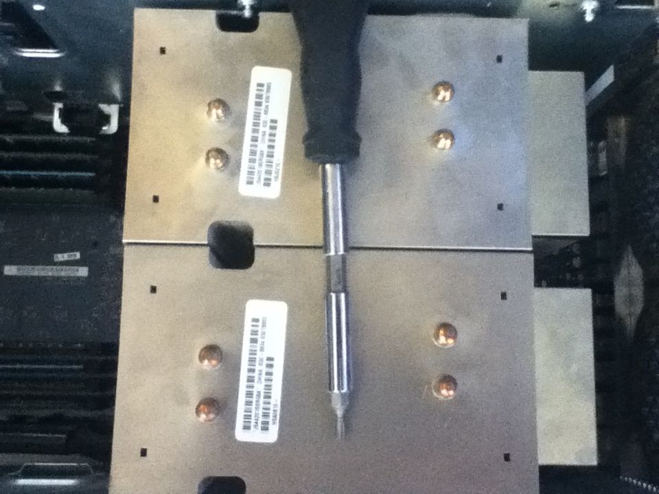

So I'm attempting to remove the power supply of my powermac G5. I've been following an iFixIt guide. (http://www.ifixit.com/Guide/Installing+Power+Mac+G5+Power+Supply/1893/1)
The problem is, I'm supposed to loosen 8 t-10 screws. I've gotten 6 of them, but 2 of them are deep inside a hole in what I think is the cooling unit, and my screwdriver/extension aren't long enough to fit down that far.
This unit looks completely different from the one in the guide 🙁
So my question is what do i do next?
As the picture shows, there are 8 round...caps? nuts? on the cooling unit..can those be removed to help access the parts I'm aiming for? Do I need to find just a much longer t-10 screwdriver?

You need longer key/extension. These 8 "things" are endings of heatsink heatpipes, not bolts or nuts.
This should help you understand how your G5 is built.

Seriously, just spend a few dollars and drop by the hardware store (I'm thinking Sears' specialty tools section, not Home Depot/Lowe's) and see if you can get an extra long T-driver, or get a rigid extension for your regular driver. That's what I did for replacing my Quad's original CPU/LCS module when none of my drivers were long enough and I couldn't order the Apple ones anymore.
Using a correct sized ratchet socket (and a bit of duct tape to stablize the lenghth), I was able to add an extension from my set, I got the screws out and finished the power supply removal.
